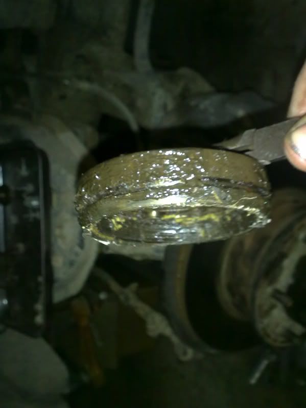

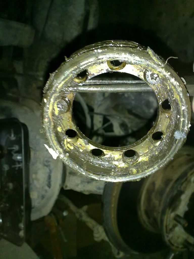

shroom
Posts: 72
Joined: Thu Feb 21, 2008 8:26 pm
Re: Help has been applied :)
Post by shroom »
the plate that is held on by the three torx screws?
I cannot see how that is load bearing/locking - but it looks like the 54mm nut has a key with a brass locking rod - photos below.
It looks like I can fit the manual hub over the 54mm nut - but will have to see to that tomorrow once i find a 54mm socket :)
http://i963.photobucket.com/albums/ae118/mrandrewdh/08092009047.jpg
http://i963.photobucket.com/albums/ae118/mrandrewdh/08092009045.jpg
http://i963.photobucket.com/albums/ae118/mrandrewdh/08092009046.jpg
Smurf
Posts: 2868
Post by Smurf »
the clutch plate screws on and jams tight against the nut?
then the torx screws hold them in place so the clutch plate works as a locking nut? I'm trying to remember from a few years back now.
You have to have a locking nut or your bearing will work loose.

shroom
Posts: 72
Post by shroom »
Smurf wrote:the clutch plate screws on and jams tight against the nut?
yes i think your right - I will just grind the clutch material off so the manual hub fits on and leave it at that. Cheers!
