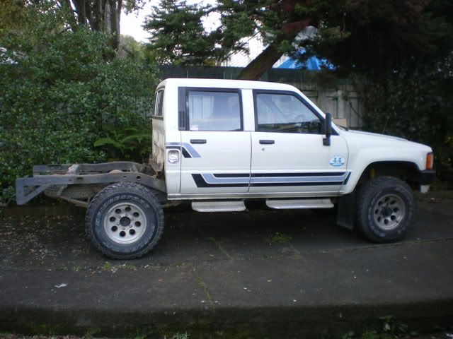

Couple pics of the new project. After a few beers with some mates trying to figure out which motor to go for, now thinking the 1UZ is more for me. Just wondering will the G52 box handle a standard 1UZ or are there better options?

dont go 7m theyr over-rated, blown headgaskits are common either go 1g, 1uz or 3.8 v6 commy

Have a look at the 1jz and 2jz toyota engines. they are heaps lighter than a 1uz and develop nearly as much power. They are also alot newer, more powerful, more reliable and easier to get parts for then the 1G, 7m etc
I used to have a ln65 lux with a 1jz-ge (2.5l straight six) and im not kidding but it was quicker than a surf i drove with a 1uz in it and another 1uz powered lux ute i went in.
Personally i think 1uzs are a little bit overrated (only a personal opinion tho)
Now ive got a ln130 surf with a 1jz-gte (2.5l twinturbo soarer engine) with steel wheeled turbos etc, fuel system upgraded, and higher boost and ive dragged evos, rotors etc off at the lights before lol :twisted: :twisted:
I've got photos of under the bonnet of both if your interested.
Also i dont think ya g52 box would be up to it, a r150 is the best option.

uz is substantilally lighter than 1/2jz ,, ... its not that much heavier than a 4age :D
270kg for the 2j
190 for a 1uz
and yes they are overated .. but thats because everyone expects 700hp
i make 150 odd rwkw .... about the same as a stock 1jzgte ..without the turbo's :d
next time your in ... ill take you for a burn in our turbo 1uz surf ... it really is quite stupid
as for gearbox ...g52 will die .. i killed hilux diffs and my g52 in mine
