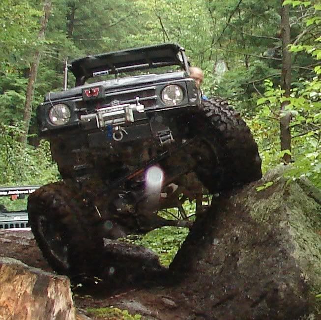

I was just winding you up on the SOA. I definatly wouldn't SOA a Zook on standard running gear, not unless your going to fit some training wheels :D :D
The stability of the truck when going accross a slope or ending up in a situation that you didn't intend is a big thing.
SOA will kill that. Your COG (center of gravity) ends u in the clouds.
Unless you put some lux axles under it, then you have the exta width to maintain a good COG.
The leaf sprung 413's flex the best, better than the later model coily's.
As the word "flex" suggests, stuff has to be able to move, deform, bend and give.
The best combination for off road in a zook is some nicely worn in leaf packs, the soft squishy factory rubber bushes and some foam cell shocks (not gas pressurised).
The standard shackles are all good, thats all i'm running. Bent one on a rock though :lol: :lol: :lol: :lol:
DieselBoy
Posts: 4568
Re: Budget Zuk Build - (hopefully anyway)
Post by DieselBoy »
If you get it wrong, you can have end up with this:
And If you get it right :)
