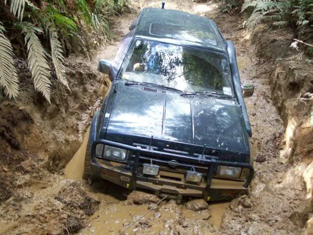

Re: Newbie :)
a torrano doing the job from this weekend
