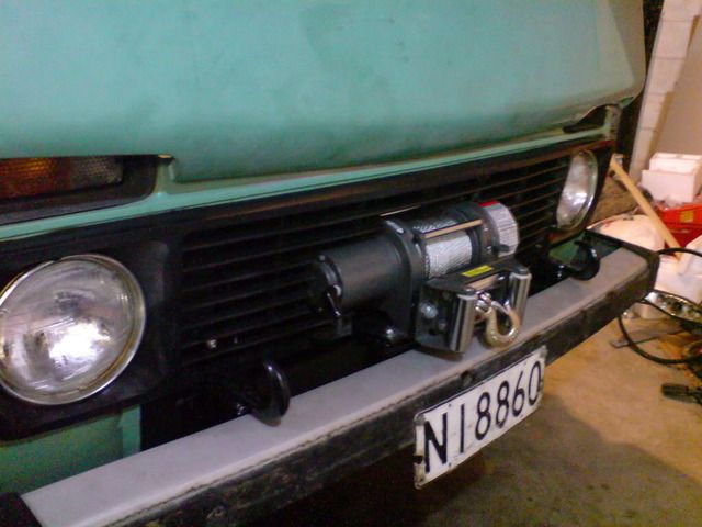

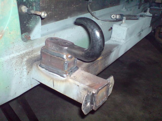

Time was pressed at the end and when it came to mounting the tow hooks I did not have the bolts to go through two 50x50 box so I just welded them on.(plus that left a route for water to get into the new bumper I made)
Since coming back overseas I have been reading posts and all about how people are touchy about towhooks and their ratings.
Both of mine were bushranger 10000bl ones and when I welded them I put a triple bead around the base and then filled the bolt holes as well. And I have huge faith in them not coming unstuck
now the Niva is only 1600 kgs and my winch is 6000lb so any load I am putting on these hooks is well under rating, however will people/clubs frown on these hooks because they are welded on? I am guessing the only problem they will have is that possibly the heat has changed the granular structure. However as I did not quench them and they were allowed to cool by air they should not have hardened and become brittle.
I would like to know everyones opinions on what your views are. Easy enough to cut them off and bolt them next time I am back home if people take offence to the way I mounted them.
