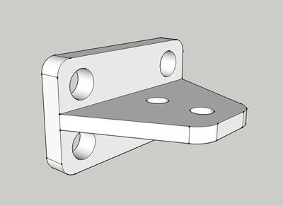

I have a pajero and I am going to mount tow hooks front and rear. I've got the front figured out. But on the rear I cant mount it directly to the bottom of the chassis rails because of the leaf spring shackle mounts. And on either side there is the rear cross member. So I was thinking I can either remove the towball and attach a 3.25 shackle, but This way I'm worried that if a big enough pull is applied it will twist the rear cross member. Or I can get a bracket made up to mount where the towbar bracket currently is so that it pulls level with the cross member rather than from below.
This is a pic of what I was thinking
Thanks

nick.falconer wrote:This is a pic of what I was thinking
Yep but with a gusset(s) underneath to stop it bending :mrgreen:

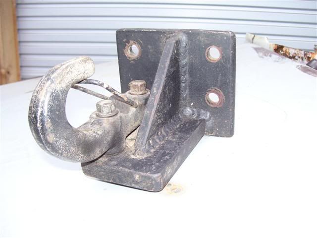

where about in nz are you as i have one sitting here that i got professionaly made it was off my pajero but i have since sold that truck, i will post a pic later. dont want much for it but wont be worth sending it i dont think as it might be a bit heavy.

sorry was so l8 on posting but here is a pic of the tow hook anyways.:)

the bolts look to small holding hook to bracket and hook dosent have cert weight eg4800 pounds

factory hook off a hilux and the bolts arnt too small for the hook they are perfect fit.

new2zukes wrote:factory hook off a hilux and the bolts arnt too small for the hook they are perfect fit.
There is the problem right there ... these are not rated and are for "towing only" they break instead of straightening ... or the bolts shear when used for snatching ...then the potential for injury or death is very great

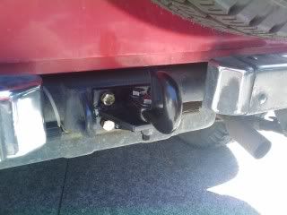

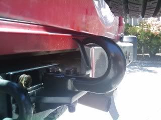

The brackets and hook is now mounted. I ended up having to buy shorter bolts as the hook bracket is thin than the towbar bracket.
This is it mounted
And this is with the rear door open above the hook. You can't tell in the photo but there is only about 5mm between the hook and the door.
