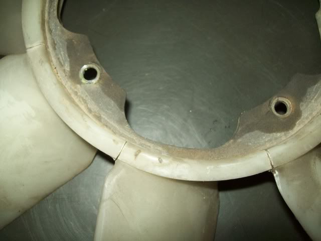

put the safari in the shop for some work on the power steer box which recieved a big hit in the weekend ,
what also was found was cracking in the radiator fan blades water pump had a stuffed bearing, radiator third full of mud and aircon condensor is the same. even though ran water through the rad fins at clean up time the build up remained,
mileage is at 22000 kms and five years of offroad
Re: maintance
Its called old age coxsy, sounds like you've caught the fan in time before the blades detached
can they rebuild the steering box or is it bent? :oops:
Re: maintance
they haven't heard back from the hydrolic people by the time i headed home tonight , the stuffed pump answered a question of a noise at idle i heard during the weekend
Re: maintance
the steering box is stuffed, got another for $300
the fan

Luckily you caught all that in time. Could've been expensive if the pump packed a wobbly, especially with the rad as blocked as it was!
I always kept a spare radiator (only cost me $20, plus $70 for a strip/rodding), and after a few muddy trips, (or 1 depending on how bad it was) I'd swap them over.
Sometimes it took over a week for the crap to soak out of the dirty one.
May do the same with the cruiser, buy a new rad, and keep the old one as a backup for after muddy trips.

kricky there years left in that fan :lol: :lol:

i have owned 5 safaris now and all but 1 had fans exactly the same as yours, maybe i should change them :? :?

All my Safari's were the same too, including the GU

(Commin problem) Replaced my fan with new one from trade me,the old one was in shocking nick but still held together.To options in the tb42 engine so measure between the bolts if your replacing them.

common problem that no one mentions :D
