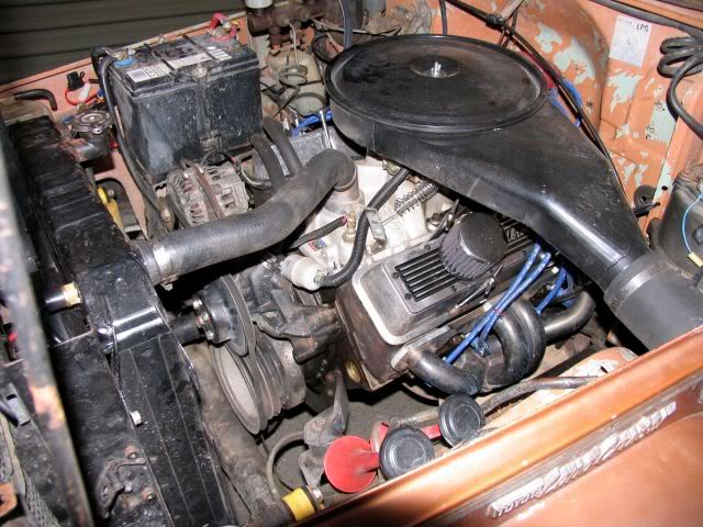

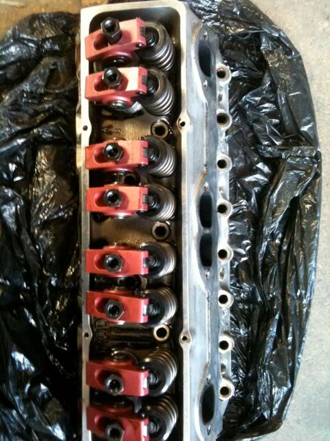

My bro has just made the call to sell the 305 Chevy powering his 75 FJ40 and repowering it with a worked 350 out of a Torana that was doing high 11's. The 350 is a bit special.
It's getting a freshen up before it goes in.
New pistons/cam shaft. It's running a solid cam, the pistons/crank will be balanced, Brodex heads, 11.1 compression, TWR pistons, steel crank, 4 bolts mains, Eski cam, Eski roller rockers, stainless steel values, dual value springs, double row cam chain. :shock:
He's not into showing stuff on ORE. But I'm excited about it so I thought I'd start a build thread for him. (I asked him first, he's not bothered)
In it's present state.

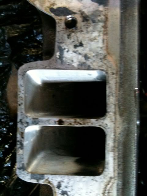

He thought the 11.1 ratio was a bit high to. So now is the time to get that sorted for what the truck will be used for, a daily driver.
Had a look at the heads today.

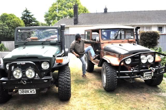

Both of our 40's together today. 8)
