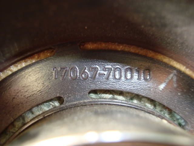

ive been given a toyota supercharger but im not sure whether its a sc12 or 14 heres what it looks likeImageImage
ive got the pulley and drive hub what else would i need to get the clutch working

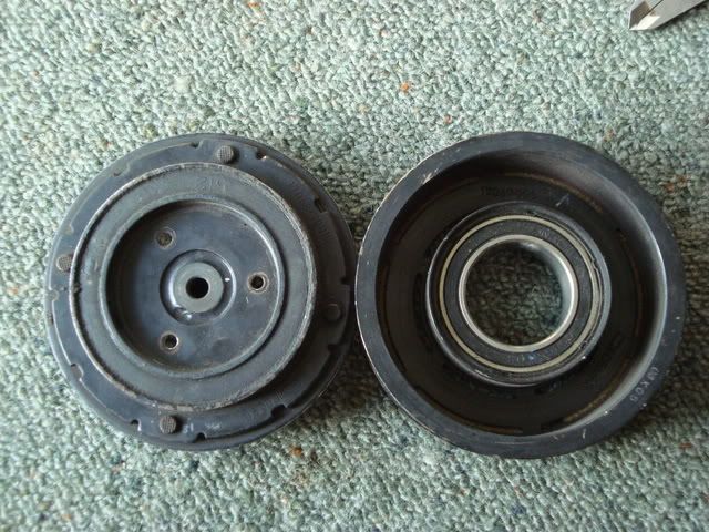

there should be wire hanging out of clutch assembly apply 12v and clutch should engage or lock to drive pulley
measure overall length of unit and i can compare it to my sc14 and let ya know, but it looks like a 14

The sc 14 is a little bit linger than the sc12 (only like 15-20mm) Pretty sure the sc12 have sc12 on the main casting.
What was it off? If it was MR2 it is a sc12 If it was a supra or prevaia (sp ) van then its a sc14
What ya gonna do with it?

heres photos of the parts of the clutch ive got what else do i need
