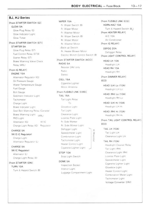

Hey all, I made a stupid mistake. I removed all my fuses from inside the cab and didn't write down the Amps of each fuse. Does anyone happen to know them? or have a look, I assume the fj's are the same? my truck is a 1983 bj42. this is my last job before i go for a wof, 3 years in the making hahah. thanks all!

tangy wrote:Hey all, I made a stupid mistake. I removed all my fuses from inside the cab and didn't write down the Amps of each fuse. Does anyone happen to know them? or have a look, I assume the fj's are the same? my truck is a 1983 bj42. this is my last job before i go for a wof, 3 years in the making hahah. thanks all!
If you know the circuits this may be of help.

Hey, thanks for that - that doesn't make sense to me. There is no cover over fuse box so no list saying what is what. You wouldn't happen to know what the order of fuses from top to bottom are? Thanks :)

According to the toyota book?
TAIL 15A
STOP 20A
LIGHTER 20A
WIPER 20A
HEATER 20A
TURN 15A
ENGINE 15A
HEADLAMP 20A

mate seemed to work although the tail wouldn't work on 15A, i put a 20A in and it worked but got bloody hot.. had to take it out hah.
