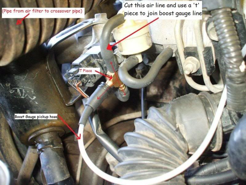

this is where i got told

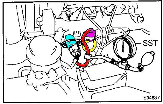

not sure if the Prado is the same as my Surf , ECU boost sensor on mine is at the front of the manifold. I'm out of town, so cant take a pic of the actual setup but have found this pic from the manual
I'm T'd into the yellow hose off the manifold , little pink thing is constrictor valve , which connects to the boost sensor (blue) via the red hose.
Can look at my hard copy manual at the weekend for ya , which covers the Prado as well, if you are still having dramas.
Does the actuator on the Turbo look like its been played with or shimmed up for more boost?
edit : just seen Snorks post :roll: ive got mine before the constrictor , which will show the vacuum in the manifold as well.

Hmm interesting. That's the one which I was saying is at the front (and where it's plumed up to at the moment) but I'm still getting 20+ psi. It's a bit hard to see the actuator but as far as I can tell it looks standard. Either way 20 or more pounds seems a shit load of boost, if it was boosting that much wouldn't something have gone wrong by now? The gauge is going off the clock.
