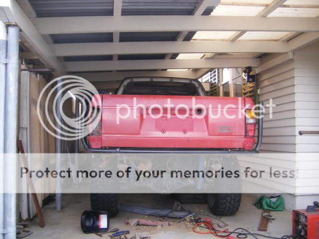

doing a ute chop and decided againsnt bob-tailing, because of the work involved and I didnt want to reduce deck space, so I instead decided to chop the tailgate and rear quarted panels (like what they do on the safaris/patrols), these areas are always getting smashed, and mine were all stacked in anyways and wanted them tidyed up so thought ide do it all at once, ive gained over 4 inches of clearance, though 30mm of that was the body lift too, reason i cut where i did was to keep tailgate hinges still in tact and working from original mounts, if i was to cut higher i would have had to modify that, today got all panels cut and re-fitted bar to suit, looks good i rekon, and factory.
tailgate cut
panels cut wit bar in original position
note where vertical bar is sitting and compare to last pic
bar re-fitted to suit

Re: chopping rear end of hilux
Post by rokhound »
Looks sharp.
Have you just folded the excess to close off the bottoms or are you grafting new bits in?
Post by J_Dub »
rokhound wrote:Looks sharp.
grafting in new bits, thought about folding it but with the ribs on the inside skin that would have been a prick, hope my panelbeater mate dont mind welding new bits in, too bad cause thats the only option now :roll:
Post by UBZ »
lookin good 8) . does the tail gate still open?
Post by J_Dub »
UBZ wrote:lookin good 8) . does the tail gate still open?
hhmm... umm yep... no, i fcuked up there.... never assume...
as standard, the tailgate is at its lowest point closed, when open, with the offset of the hinges the bottom of the tailgate kicks back and under, but as ive got it now, hinges are the lowest point, and when open, the gate sits 20mm lower, so im gona have to hang the tailgate so its opens side ways... so ive lost my seat/table :?

no dramas though, wasnt even gona have a tailgate, or was gona weld it shut and graft gate to body, dont realy need it functional now its a ute
Post by rokhound »
Heath wrote:
just waiting to plow anywhere you go. Great job. :wink:
I have never dragged the arse end of my surf on the ground to a point where it has impeded progress. Mind you it had a 75mm rear bar and was about 10 feet off the ground :lol:
Jdub, is there some way you can relocate the factory hinges? Even utes have working tailgates.

Post by muddyhilux »
its a bit hard to see from pics but if you just dropped your bar 30mm would that fix it?i kno youve just redone mounting etc but yeh,might be the quickest fix and a working tailgate will make things alot easyer

Post by J_Dub »
rokhound wrote:
and you got 39" wheels????
mine is factory height, and i wana keep it that way, with 33s get virtually no guard rub, none at all in the back, have eliminated most in the front with my flash :wink: flared guards and the little i do get in the front will be fixed when i do hi-steer, then ill be able to fit 35s, so by chopping the excess shit in the back ive gained what you would with a 3" lift

muddyhilux wrote:its a bit hard to see from pics but if you just dropped your bar 30mm would that fix it?i kno youve just redone mounting etc but yeh,might be the quickest fix and a working tailgate will make things alot easyer
problem there is these surf t/gates are about 4-5" deep, ute ones are half that, so you gota allow for the depth of the gate when open thats how much it will drop by. The factory gates hung down below the hinges about an inch more than the gate is thick, so when there open they are an inch higher... plenty of ways i could fix it, i dont wana drop the bar though, ill figure sumin, not a priority

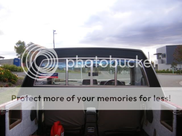

Post by J_Dub »
finsished cab extension piece, fitted sliding window
not sure if i like how it angles back, may just cut it square, but i did it that way knowing i can always cut it later on

Re: chopping yn60 hilux surf
simply very nice
Post by motorhead »
Looks great, leave it. Never change an answer on a test...go with your first instinct 8)
Post by J_Dub »
cheers fellas, ya never realy certain of what something will look like when its new or custom.. will be leaving as is for now, not hard to change later on
Post by JONO250 »
looks bloody good. are you planning on sealing off the lower area of the cab at all?
Post by J_Dub »
JONO250 wrote:looks bloody good. are you planning on sealing off the lower area of the cab at all?
and yeah i ended up getting an ln60 but had to get one from down the line, had to buy it site unseen tho.
yep will all be sealed off
