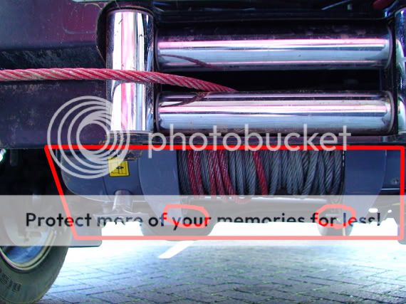

Richard at AKL 4x4 seems to think he can get 32" on mine without too much hassle. His next job is to fix the arb bar and winch, then lift it, followed by tyres, then arb locker in front diff as Visa recovers on each stage. Hopefully all complete in a 6 month or less time frame unless Wife locks the visa card away.
The particular arb bar i have and the come up winch it hangs too low. Hit it on Friday at The Farm and broke one side of the casting at one end that holds 4 bars that hold the sides together, plus very minor movement in the bar.
Definately too low, but hopefully the lift and bigger tyres will help that, got bellied in one spot but winched off ok.
Will try Woodhill today and see how it goes, less clay and more sand there should be fun.
Edit: Will post a pic of the Winch and how it is hung as soon as. Wiring and freewheeling lever both hang about 6" below the bottom of the bull bar, way too low really. A big plate will protect it and front steering but hopefully Richard can raise it up a bit. Other option is to change the bull bar or winch which is probably a bit more of a costly option. Bar looks like it is made for Warn as it has a big W cut in the top of it.

125mm below lowest part of bar to lowest part of winch.

Well.....thats not going to be easy to get at when the front is in a hole

you'll need to protect that winch motor as i think youll find the end casing is only ali and won't take bashes very well. Also youll be constantly drowning the winch in any puddle, hole or river crossing so you will need to constantly clean it.
edit -
you can see on my one i tried to keep it up as high as possible and you can see on my bash plate pressed on mud, this is what will happen to your winch if you dont cover it somehow and it only takes a rock in the mud.
edit -

I have possibly found another bar that the winch MIGHT fit up inside thus raising it up maybe 250+mm, will have to do some measurements to check. Then ditch the ARB bar.
The ARB bar is not physically wide enough in the back to take this winch up inside due to the zig zag things on either side I guess crash protection sort of things so the majority of the winch hangs below it.
