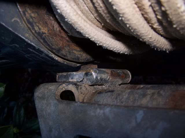

What is wrong with the original roller fair lead ?
I just welded a couple of pieces of round steel by the side rollers to stop the synethic rope getting cut.
Cheers Richard

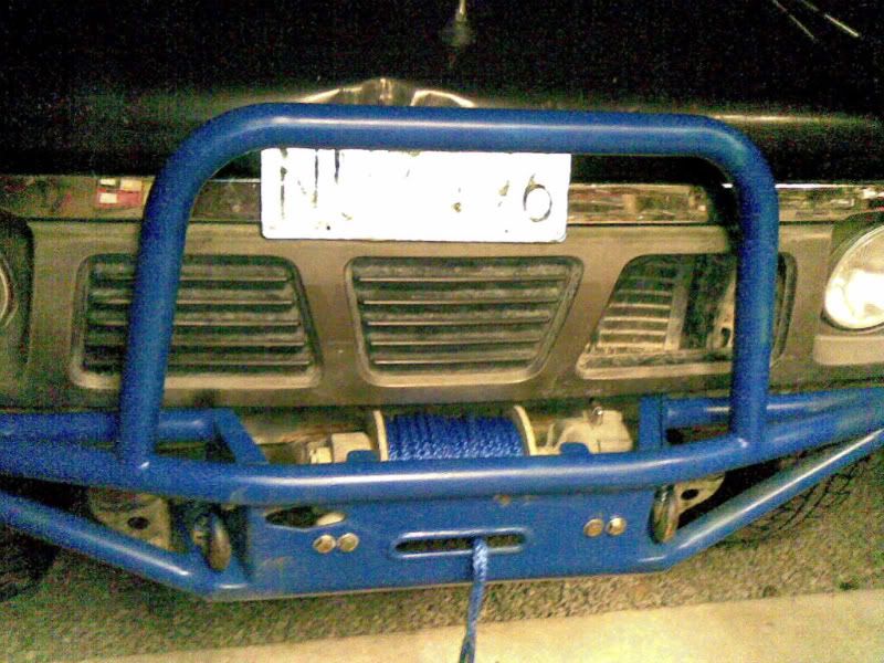

Re: sinthetic rope fair leads
I used 1/2" round steel bar, bent into shape (oxy) and welded into cutout in winch front. Paint needs retouch every now and then, but no biggie, Stainless next time, though...
- mudlva
- Posts: 2918
Hay Terry very nice
a mate is going to look at work to see if he has any alloy plate kicking around.
if not your idea will be the next to use
thanks for the photo
Bulletproof wrote:What is wrong with the original roller fair lead ?
Cheers Richard
Do you have a pic of your setup Richard?
I agree with "Diesel boy" and think rollers are better. I do a shit load of winching and have never had trouble with the rollers.
The main thing that stuffs the rope with rollers is that the rope builds up and gets cut at the end of the roller.
To over come this I welded a piece of 12mm round rod behind the fairlead to give a biggger overlap between the vertical and horizonal rollers.
I have no trouble at all.
Cheers Richard
Cheers Richard

You are completely right about the friction but that wasn't the point I was making. The point is that when the rope bends there is internal movement and combine this with grit in the rope and it causes wear. Roller or not doesn't change this, only the radius of the bend. The bigger the radius the less bending of the rope and so less wear on it. The wear from rubbing on a fairlead is pretty minimal in comparison so the focus should be on the radius of the fairlead NOT whether it is a roller or not.
It was the rubbing, or rather "grinding" over the alloy hawse fairlead that did the damage.
Thats the why the fairlead had 5mm deep grooves in it, the overbraid was worn through and the rope had become a grey colour from ground up alloy in it (rope is orange-ish coloured under the o.braid)
That obviously had nothing to do with the radius
It was quite clearly the friction created by a dirty rope getting dragged over the alloy hawse that ground everything to pieces.
My vote is still with the roller fairlead!!!!!!!

ok guys
thanks for the advice.
im going for the plastic idea and been to see Mulford Plastics in Henderson Pl Penrose AK
I have giot a biggish peice of 25mm Tivar 88 premium grade (blue hard stuff)
i have enought to do 2 or three peices and will see how it wears and will changes back to rollers if it does not proform as hoped
regarding the diamater of the rollers verses haws systems
over the years i have broken lots of ropes and ive never broken one at the fairlead its always been at the "crink" on the rope when its been squashed into the drum by rope above,
ive never played with synthetic rope and was hoping that this may not happen as much
cheers Rohan

DieselBoy wrote:It was the rubbing, or rather "grinding" over the alloy hawse fairlead that did the damage.
That obviously had nothing to do with the radius![]()
We are talking about different things.
The rope has a recomended bend radius.
The rollers on a roller fairlead are smaller than the recomended bend radius so WILL cause internal damage and shorten the rope life. They will cause damage whether the rope is clean or dirty.
Obviously the dirty rope sliding over and grinding away the fairlead is causing damage. (no one is saying it doesn't)
Internal rope damage is what really causes the rope to break. The external damage is more of a cosmetic problem (but obviously does damage the rope).
I have tested (on Cookes test rig) rope that looked like wool and yet it was still breaking at 5500kg. (10mm) When you pulled the rope apart, the inside of the rope was still very good but very rough on the outside. This is rope that new had BS of 8,700kg (10,900kg less 20% for splice)
The facts are that both common types of fairlead do damage to the rope and the solution is rollers of the correct size but that is inpractical for most people. The compromise that will maintain the strength (not visual appearance) of the rope is a hawse fairlead.
http://www.dynamica-ropes.dk/html/features.htm
This tells you that the recomended bend diameter is 5x rope diameter. So a 10mm rope needs a 50mm roller minimum. The bigger the roller then the less internal movement of the rope and the less damage.
The little rollers a lot of fairleads have WILL cause internal damage but less external damage.
Internal damage is more critical to the ultimate rope strength.
A fairlead is a compromise so make the decision based upon the facts about the rope not a visual observation that only has part of the facts involved.
