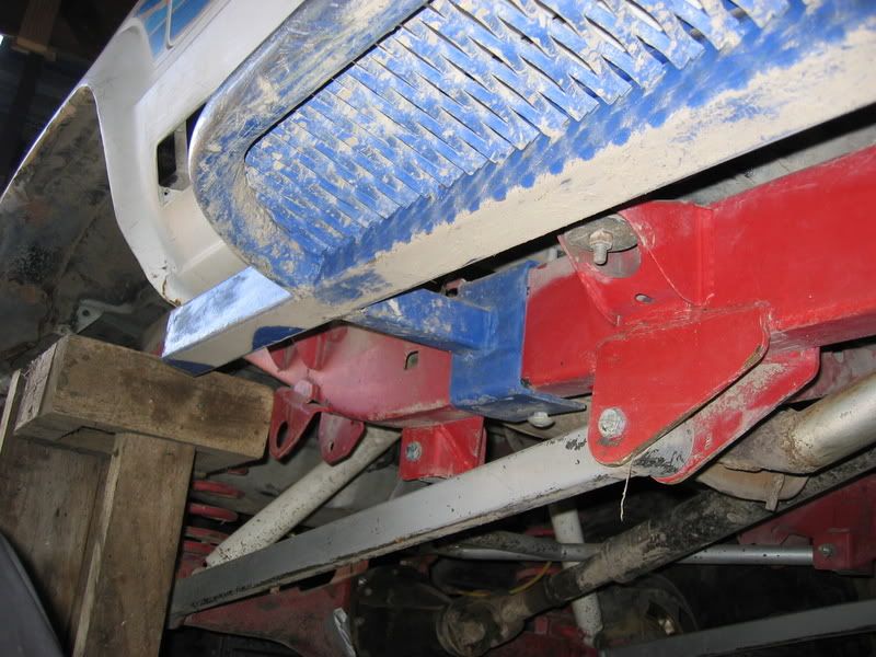

I did the same thing, except mine don't bolt through the chassis rails at all, the clamp around it, and I challenge any on here to give their side bars more of a hiding than mine have had :wink: :P
This is how they were on the old truck, and I am using the same bars again, My exo also mounts on these

Those pics were exactly wat I'm after cheers heaps mate!
