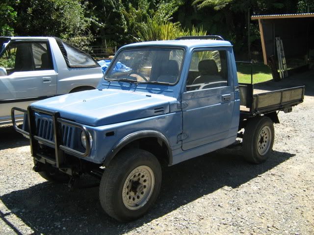

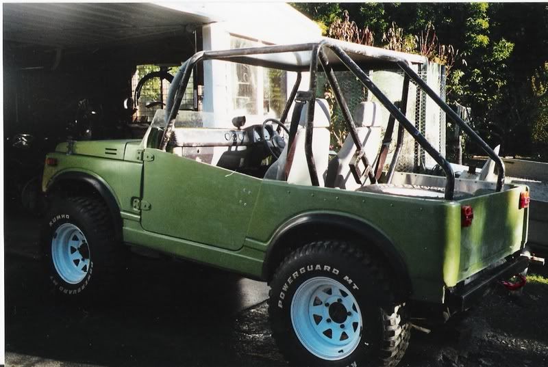

Having looked at all the Zuk builds on here i thought it was time i started mine.
After having a few (410/413) ZUks over the years (including a coil sprung 410) then a Escudo i've decided i wanted to get back into a SJ.
I'd always been impressed with a friend of mines SJ413 LWB Ute which had been fitted with a Toyota 1NT Turbo Diesel engine, 32x9.5" Swampers a set of Calmini Transfercase gears and a Lockrite in the rear. That thing went pretty much anywhere he pointed it!
There not that many built LWB Zuks about compared to SWB's so a plan was hatched.
I wanted a street legel SJ413 LWB Ute.

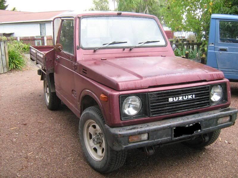

I Picked up this 410 on Tademe - It has some bad points: Its a 410 so smaller CV's, Different chassis to a 413, Not registered. It did have one MAJOR good point.. It has a full fibreglass cab!! No more rust.. EVER
I started collecting bits for it which included some live plates off another truck (which i still have) and also went halfs in a SWB 413 - I wanted to use the 413 running gear. After i picked the truck up it sat for awhile - (Buying a house got in the way of its progress)
Not very long after i'd moved to the new place i noticed another Zuk ute up for sale. This one had a current WOF and rego and was bone stock, so i raced up north and grabbed it - it will be a lot less dicking around at the end of the day and a lot less work.
So heres what i'm after.
SJ413 LWB Ute
1600 16Valve EFI Escudo Engine
External cage, Bullbar, sidebars etc
Rear locker - Lockrite or perhaps Airlocker?..
Rear mounted winch
31" Silverstones - I already have these
Cut the front gaurds for clearance
Powersteering
Rear tipper tray??
Rear disc brakes
and a few other bits'n pieces

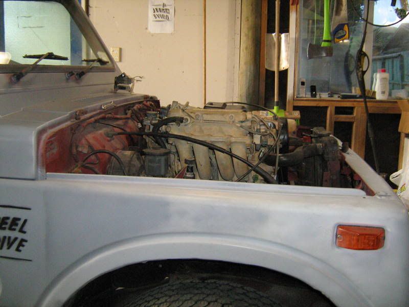

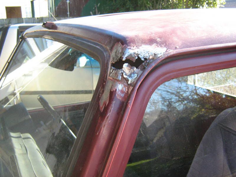

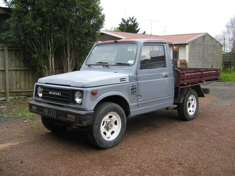

First things first the WOF was due in a month and the was some rust in the top of the passenger side A piller and also the front gaurds had rust around the bottom edge where they all go. Didnt look to bad until i started cutting it out.

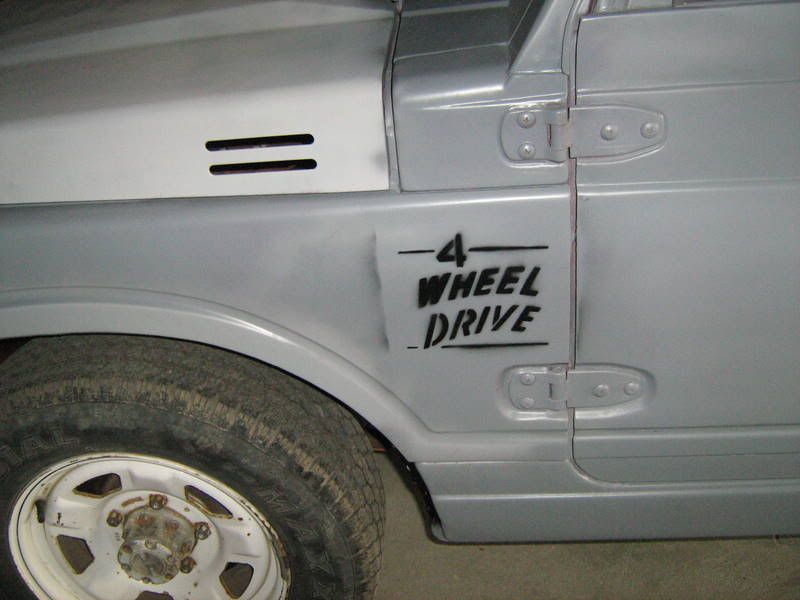

Once the rust was fixed it sprayed it with primer paint. Also added a logo from another brand of vehicle which i think looks good - Who can guess whats its off??!!

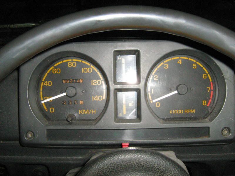

The fuel gauge had been playing (not reading all the time) and the utes dont come with a rev counter.. Gotta hav a rev counter ;-)
I have a spare speedo cluster in my spare parts department (my shed) so i removed the old and put in the new - 100% plug n play - I now a rev counter and a working fuel gauge - Though my milage did instantly increase by 5000Ks :(

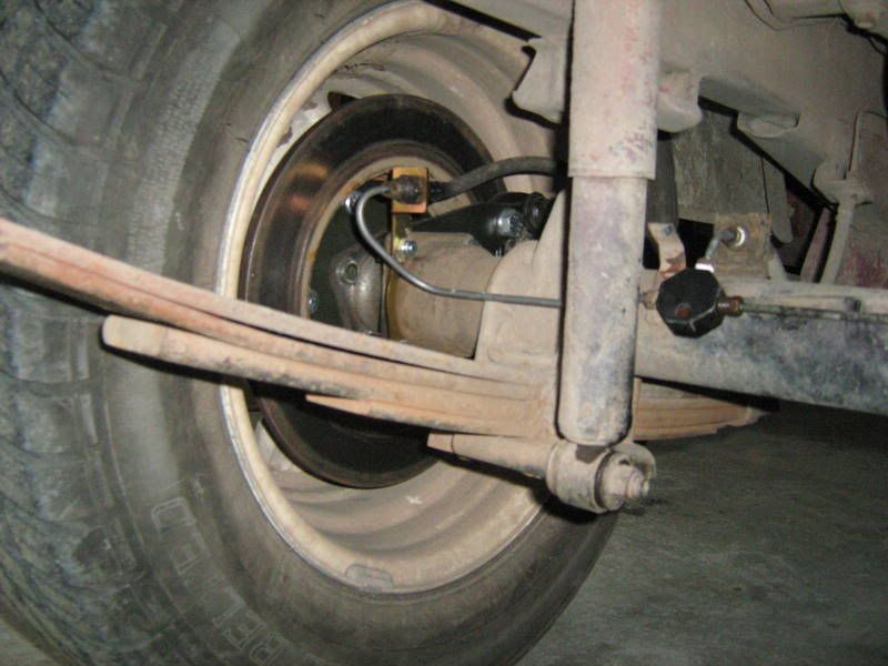

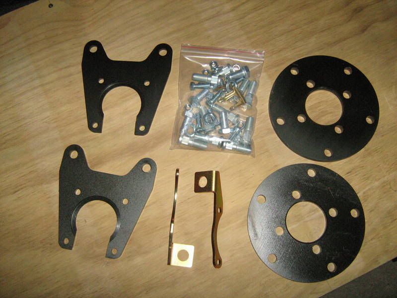

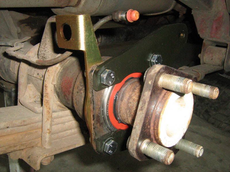

I hate drum brakes. First puddle you go through they get wet and stay wet and once mud and crap gets in there that just acts as grinding paste. So I grabbed one of Bens disc brake conversion kits. I had the first rear disc brake conversion kit he made for the Escudo/Vitaras and had no issuses with it at all so i happily grabbed one for this truck - All his stuff is very nicley made.

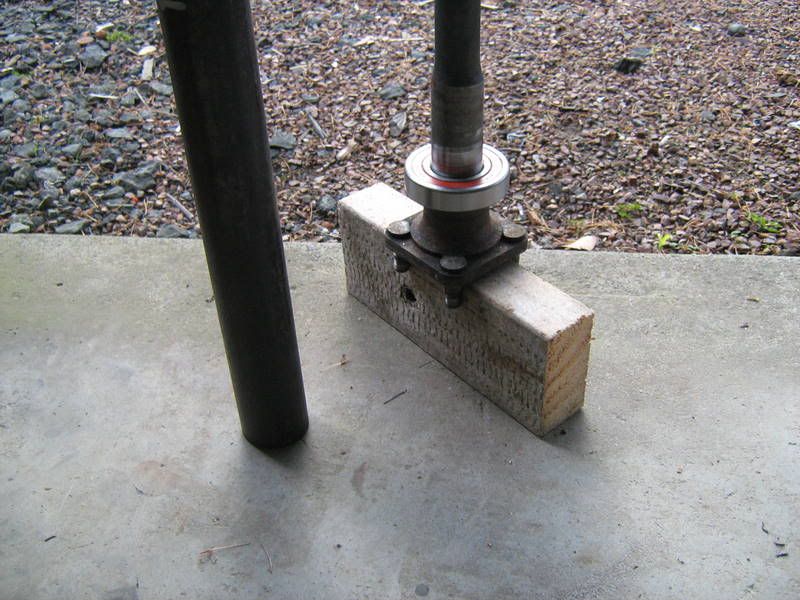

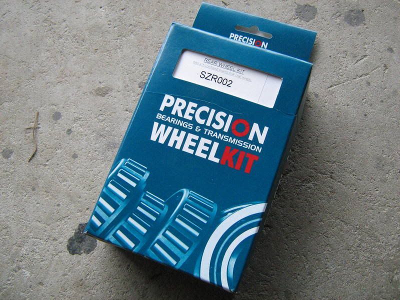

With the axles out I installed the new wheel bearings using two special service tools :wink:

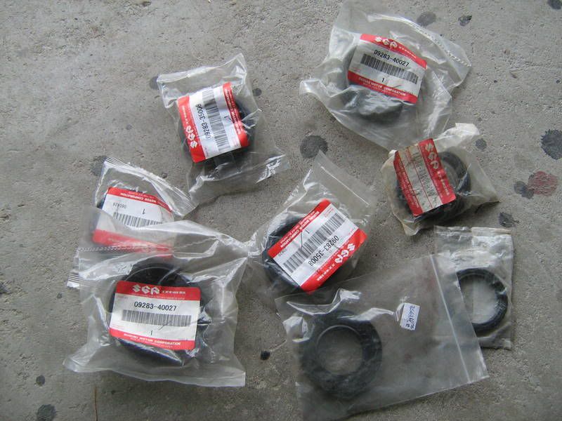

Found a bunch of genuine Suzuki seals I've had since god knows when! But I used the ones that came with the kit anyhow.
With the axle fitted the calliper mounting bracket is fitted along with the brake hose bracket.

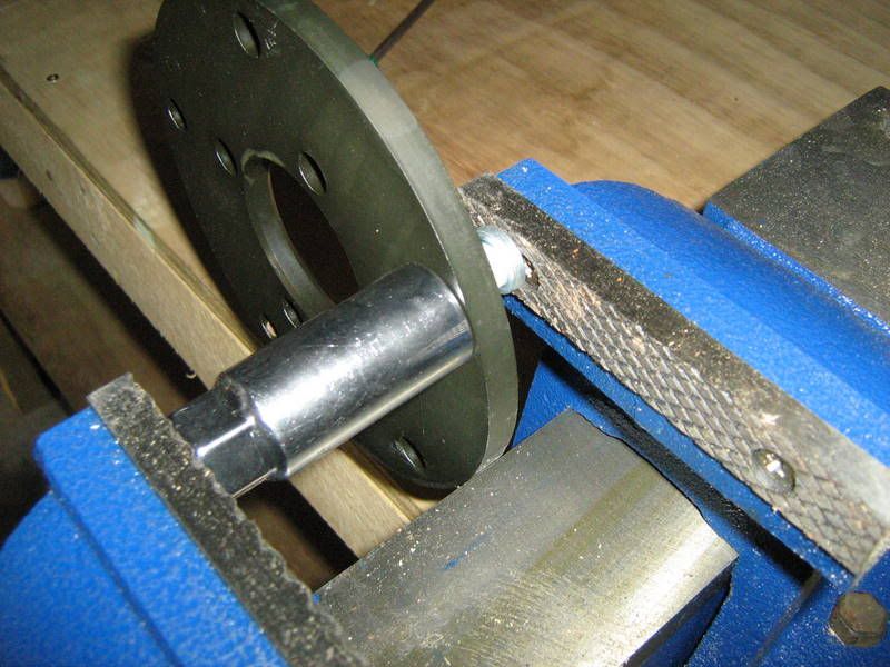

Next up press the new wheel studs into the wheel mounting plate and bolt the on.
Now you gotta make some new brake lines - I reused the R/R line as it only needed bending at the calliper end and a new flare where it meets the 'T' junction. Made a new one for the other side though.
This is where i forgot to take a couple of pics :oops:
I had a Wilwood adjustable proportioning valve floating around so i put this on and made a couple of new hardlines to suit.
Lastly I bleed the system with some nice new brake fluid. A quick drive up the road i came back and rebleed the system to get the last bits of air out. Once done i went for a half hour drive about the place and along some quite gravel roads so i could jam the brakes on to set the brake balance up ok - some fine tuning may be requiried but it seems very good now!
All in all a well worth while exercise as my truck now stops on a dime and no more crappy brake shoe adjustments! 8)

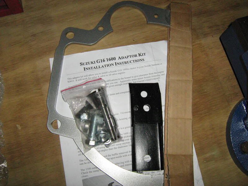

I got another conversion kit at the same time as this one. It looks like this..
And also involves one of these..

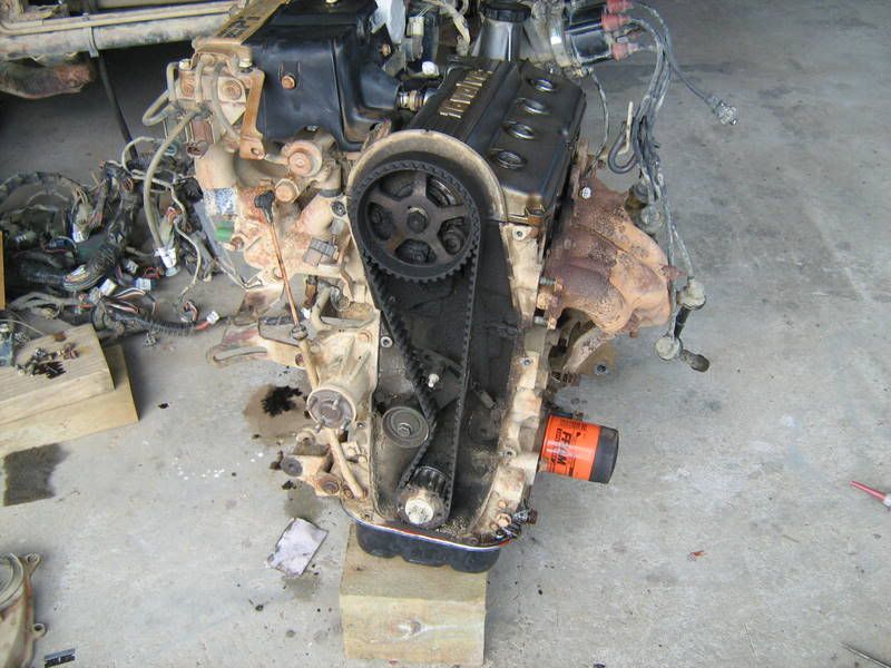

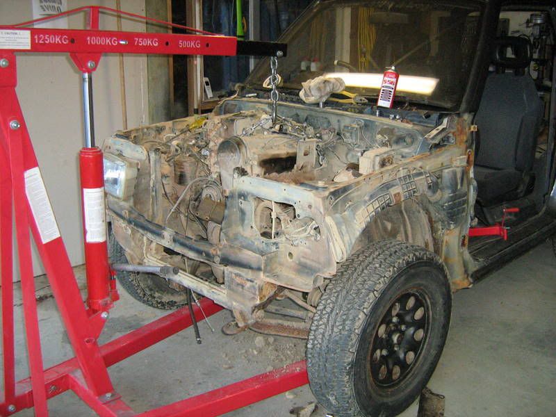

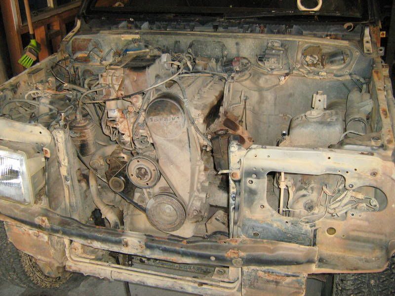

Started to strip some parts off the engine for easier removal - This thing has had a fairly hard life with the last 7 or so years having been spent all off road so every thing is caked in mud and clay!
Got some bits of the engine off and labeled a few the electrical bits which will make it a bit easier when trimming down the loom.

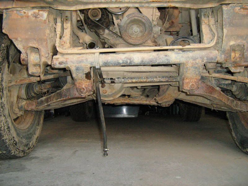

Evidence of its hard life... Check out the front crossmember and also the the crossmember under the diff - Wondered why it didnt handle so well on the drive home :shock: :mrgreen:
More progress next weekend with a bit of luck :D

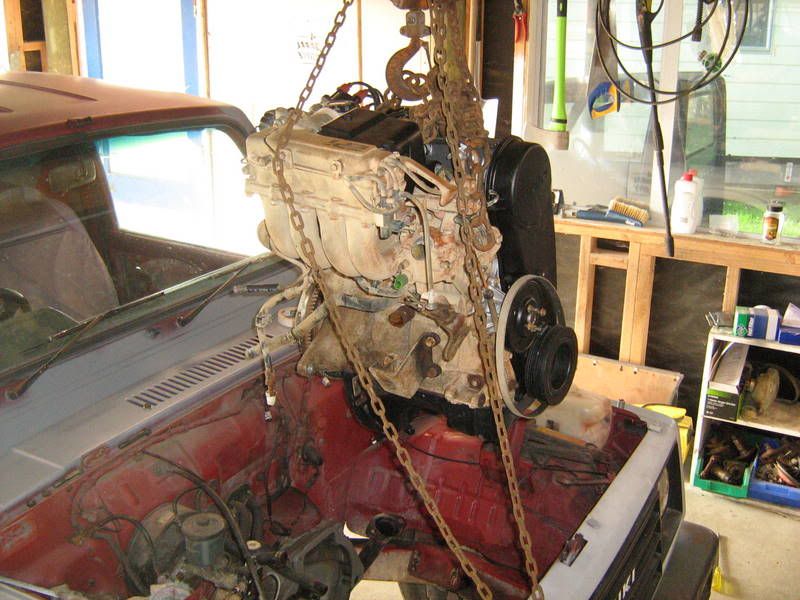

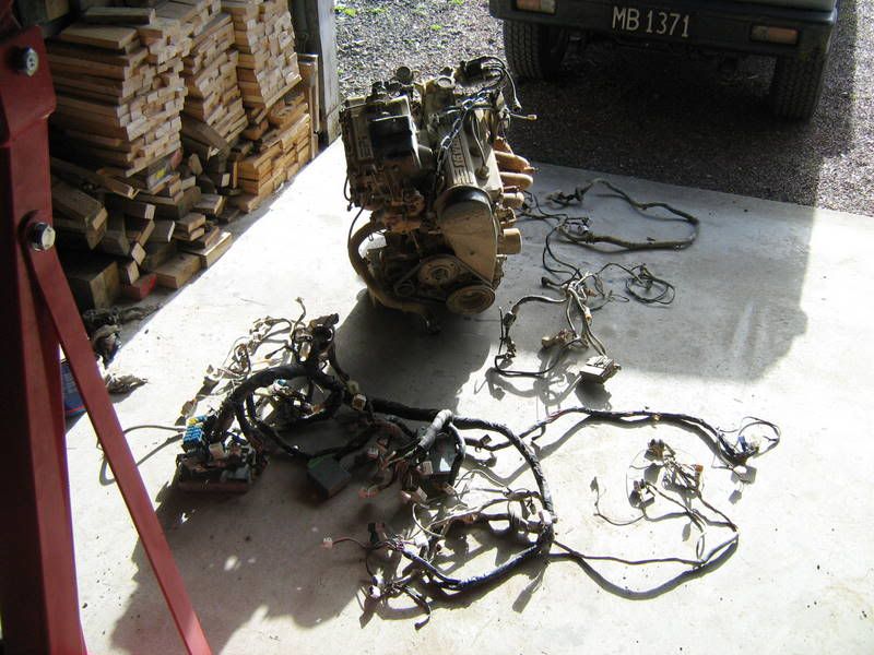

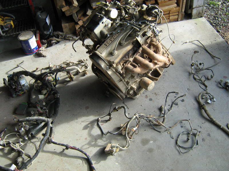

Spent most of this weekend getting the motor and loom out of the donor truck. Every bolt seemed to be super tight! Borrowed a engine hoist which makes life SO MUCH easyier :D
Stripped about 95% of all wiring out of the truck too... also labeled everything for easy identification for the next job of timming it all down.

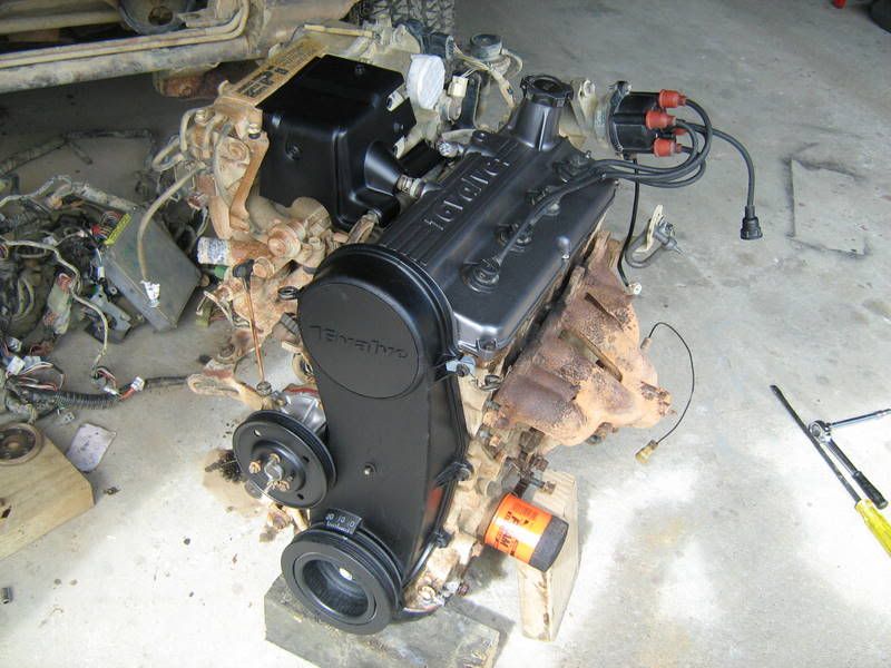

With the engine out i pulled the sump and oil pick up off. I had a spare buggered 413 motor so i grabbed the oil pickup off it to modify and also the deeper sump to use.
Once the (Escudo/413) pick up was welded back together and sump put back on I thought i may as well change the cambelt whilst the engine was out as i dont know if its ever been changed in its life...
I bought a bunch of parts including the cambelt, tensioner, waterpump, Cam/Crank/Rear crank seals and the rocker cover gasket set. Tidied up some of the bits with a bit of a repaint - Anyone know of any good cleaners that will take rust stains off alloy??

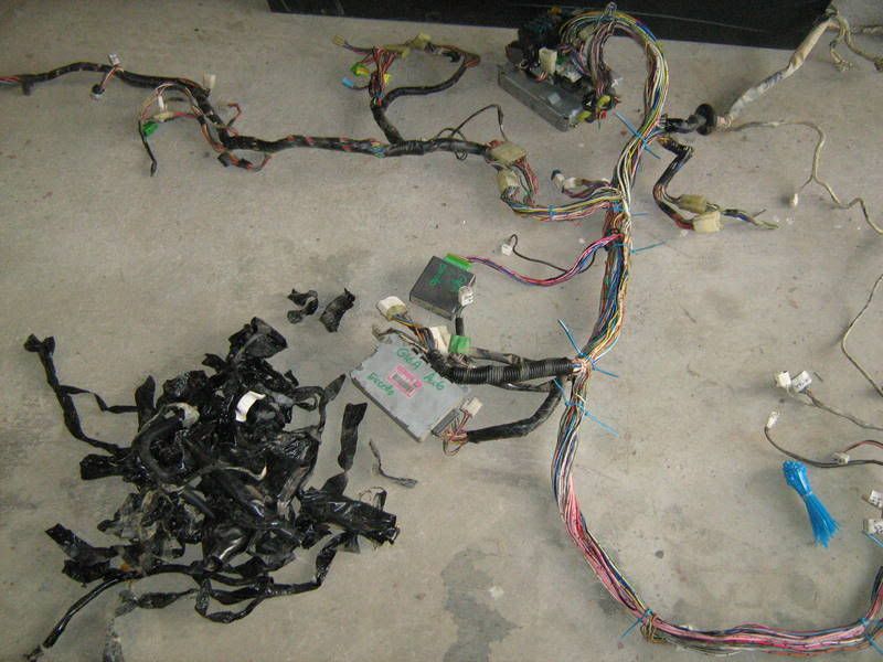

Now for the part I've been putting off.. The wiring!
A quick chat to Ben whos done a few of the looms before reckons there not to bad - Just gotta take my time. I started on getting most of the insulation tape and plastics covers off - Over this coming week I'll try to do a bit more each night.. I had thoughts of plonking it in my lounge and doing it while watching telly.. :wink:

Worst part by the look of it is the tape is gone. Found that to be the biggets pain in the arse. once its gone you can take it down to almost nothing. That's from the fuse block that is. The engine side needs almost everything... :mrgreen:
Have fun.

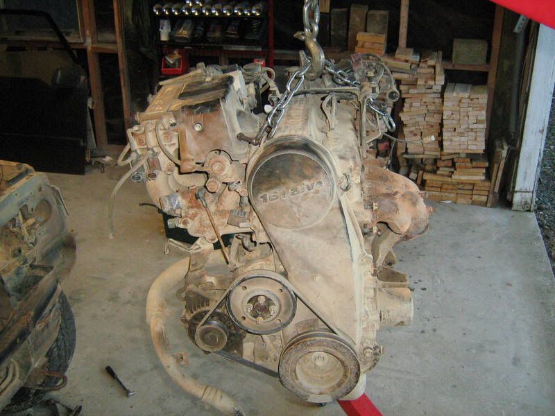

Time to say goodbye to the old engine...

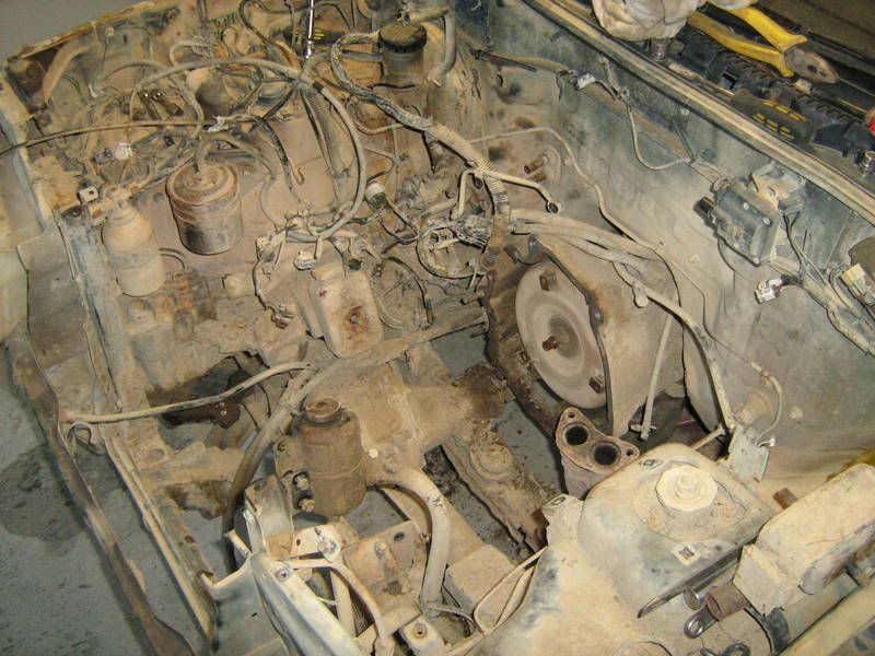

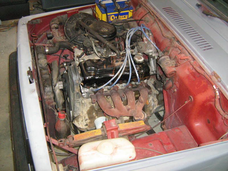

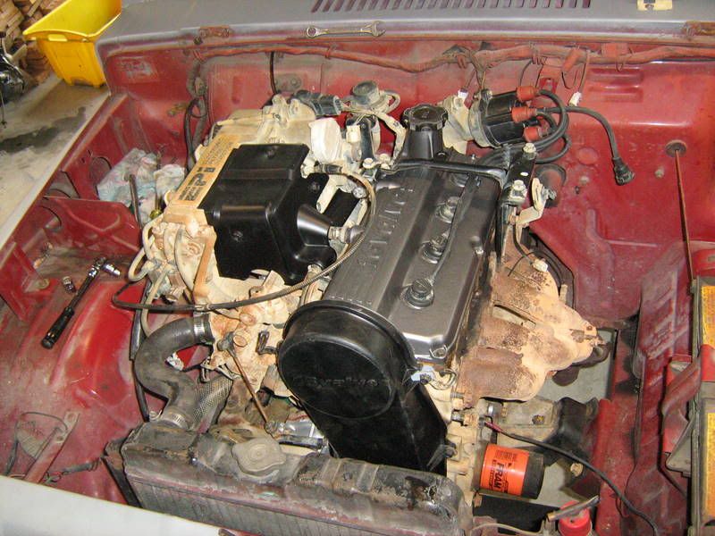

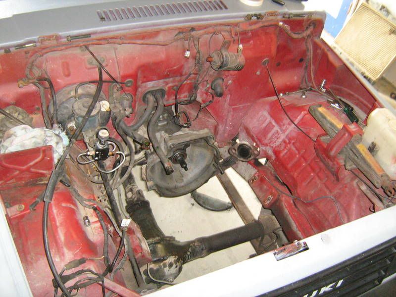

Got it out in about 1 1/2 hours - Worst part was trying to hook up a anchor point to attach the pulley block too.
The new engine went in VERY easy. Zuks are always so nice to work with :mrgreen:

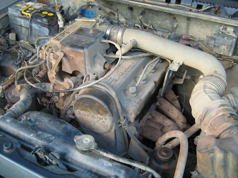

I'm gonna run the original radiator to see how it copes for the moment. I have the original Escudo radiator if i need it but I'm being lazy :roll:
Managed to get all the cooling plumbed up, Sorted out the accelerator cable and a few other minor bits 'n bobs. Still got the wiring to deal with - This is all currently spread out all over my lounge floor. Also I need to mount the Escudo fuel tank and get the exhaust sorted out.
Gonna have to modify the bonnet with a scoop to me thinks!

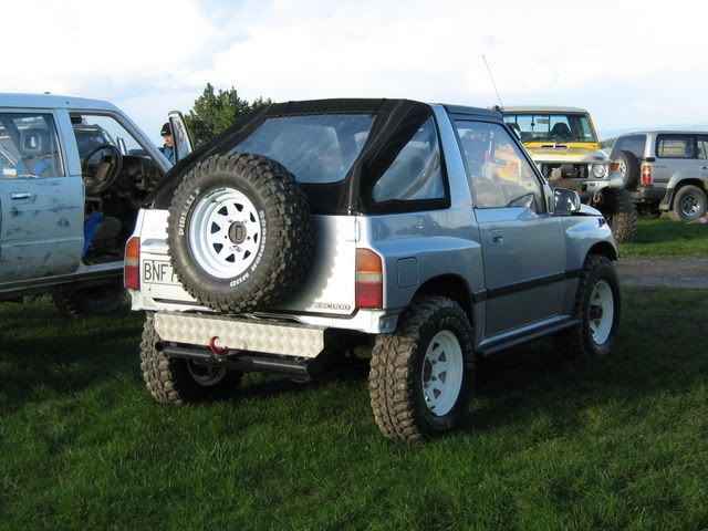

Selling the tyres on the vitara?
