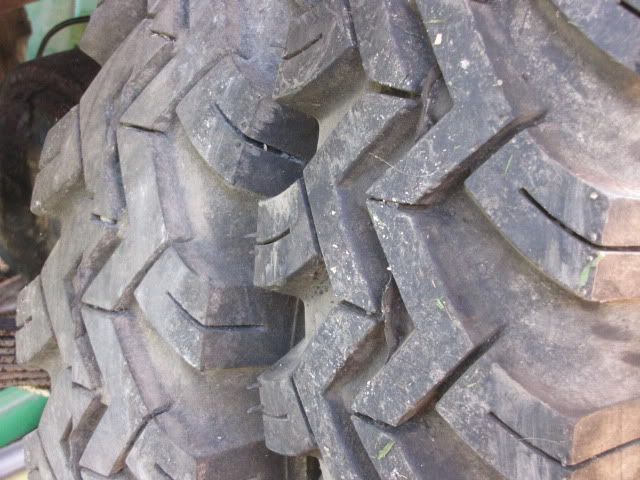

Performance wise a brand new Firestone SAT was miles better than a new retread.
The retread never had the depth of tread that the new one had and also the retread was quite flat across the case. The new ones had a case like a tractor tyre which made them self clean alot better.
The down side is they were a dog on the road and wore out between 5-10000 Ks. I used to buy a brand new set every year or two.
Here is a picture of a brand new Firestone SAT along side a brand new retread.
The new one is on the right and the new retread on the left.
Cheers Richard
