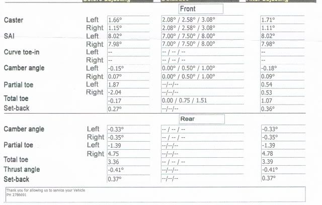

the print out for the rear axle
had a wheel alinement rear axle is taking a pounding
Re: the print out for the rear axle
when i brought my safari i put new tyres on it and did 1 trip to chch from dunners and chew the back ones out, diff bent 19mm , a friend "s one bent 9mm
well that means mine pretty good then only 4mm
How did you know you had a problem? My GQ has got a noise coming form the back but has had diff head rebuilt. Sound increases and decreases with speed and fluctuates like a fluctuating whine but its not from the diff head. Wheels both rebalanced and still same noise. Kinda annoying but been doing it for ages.
because it was put on a new hi tec wheel alinement machine oh gross weight is 2468kg
Oh OK. So you did'nt have any tell tale noises you noticed? Bugger.
