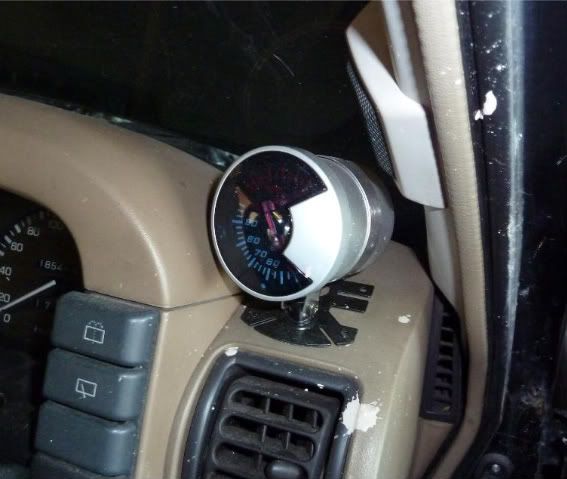

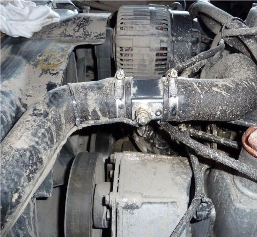

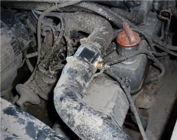

I've done it (inline temp) and find it works great, had a faulty Viscous Fan and temp went way high, but factory needle just started moving when I noticed the steam. Now I can see the temp moving from as soon as the thermostat opens, I feel much safer knowing where my temp is now. Will add a pic for you if you wants one
