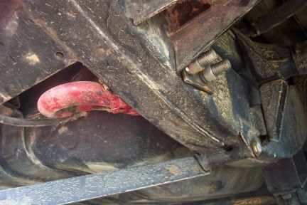

I'm sure what you're planning will work fine, I went down a slightly different route & bolted my hook to the chassis.

Mount it through the chassis like above, less time pissing around.

Just remember that if you do, put crush tubes into the chassis rail before tightening the bolts.
