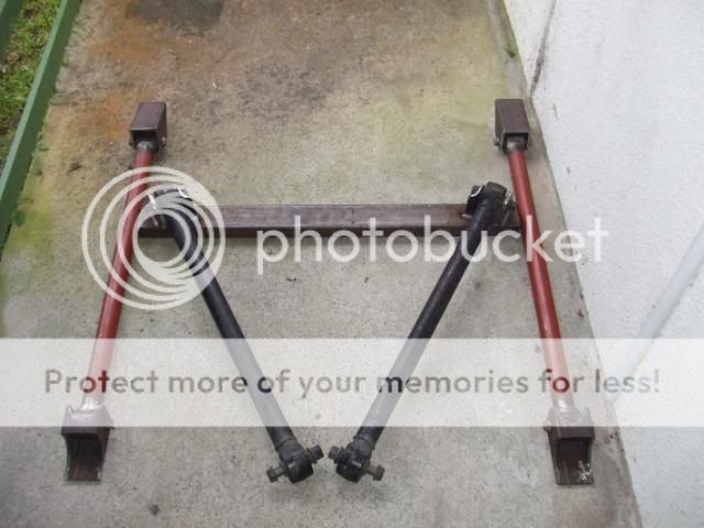

I used GQ upper links for my lowers. Cut the link in half put that into 33mm OD (I think, not sure on ID) then put 44mm OD pipe over that an welded it all together. I got the pipe from steel traders in lower hutt but steel an tube or fletchers will be able to supply what you need
All the pipe I used fitted together quite tight so all up I ended up with links that are near 10mm thick.
Are you any good with a welder :wink:
I didnt take any pics when I was making the links but heres one before I pooed them on the black ones are 80 series lower links
