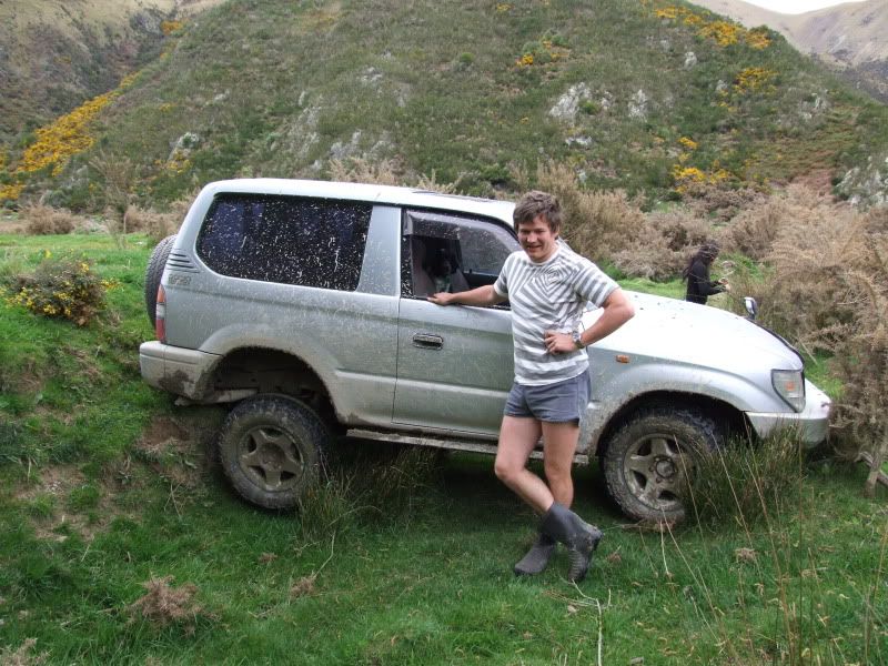

its that model. thats not me, thats me mate who got it stuck in a stupid place while i was fishing.

P.S Thats not stuck :lol: :lol:

and yes my kux it was stuck both back wheels where off the ground and the offside front was hanging there as he'd sat therr and spun his wheels
