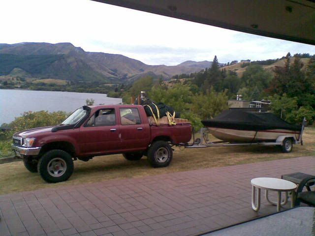

A few pics to keep it interesting
In this shot you can see the tie down holding the rubber on the hole int he fuel tank! Still on the list of things to do....
the old girl loaded up after a boys weekend away
