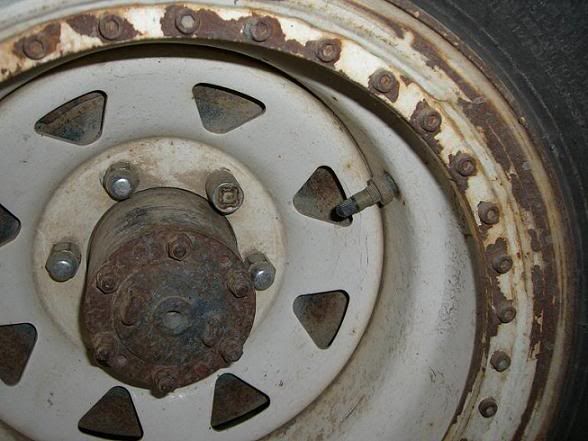

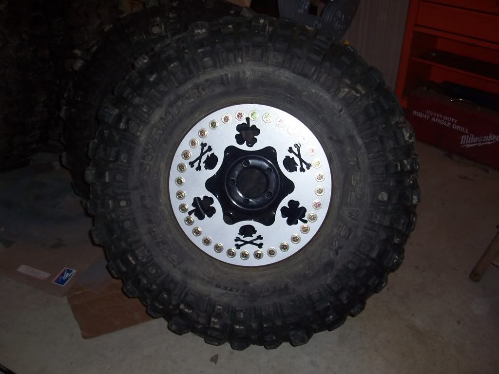

cheers for the pics sadam

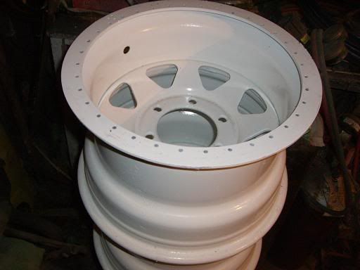

Re: bead locks
chrome wrote:like these flat ones
have you got more pics, they could be just a cap thats screwed over the top dude
or have a look at these wheels..............
http://www.cowpertrucks.co.nz/beadlocks-p-121.html
