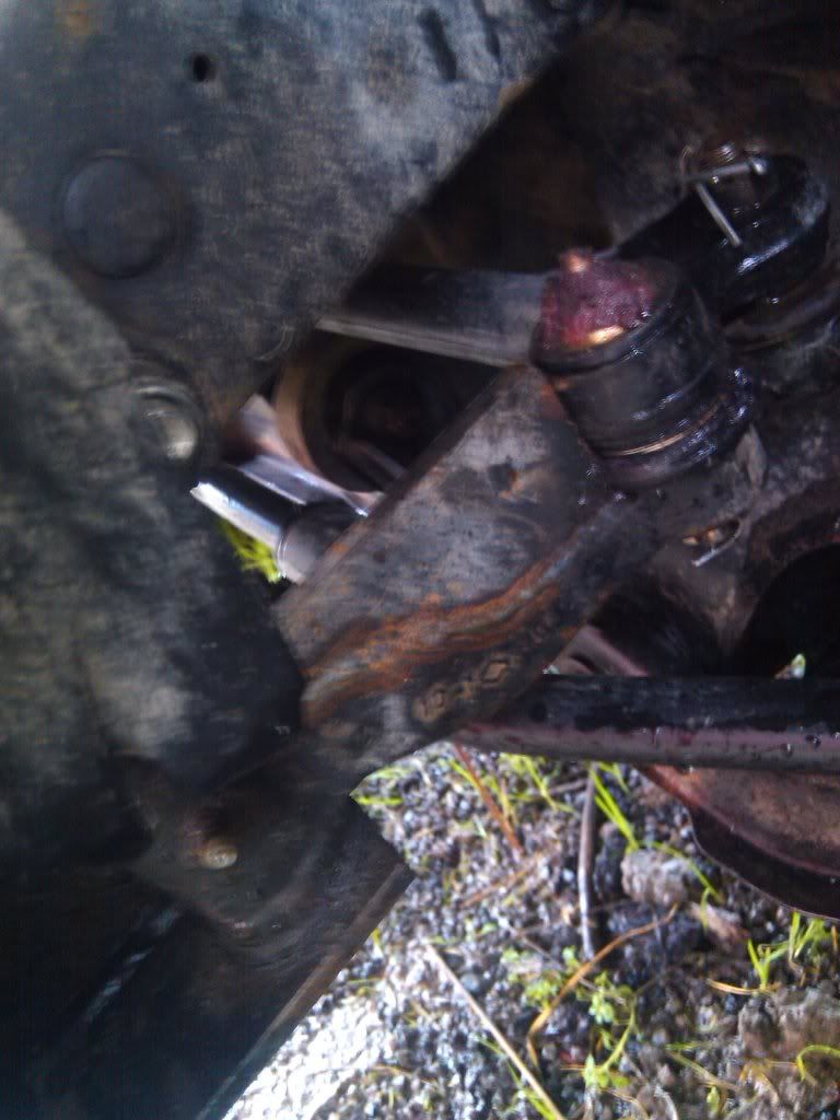

realise the threads a bit old but made this up for brother n laws truck couple of weeks ago and just got pic sorted,steering a lot better now with new idler and brace

i have done this also and managed to bend the arm... so welded a gusset on arm stops it from bending
i know its not wof standard so just change it when i go for wof lol will put up pic when i can
have a look
have a look
