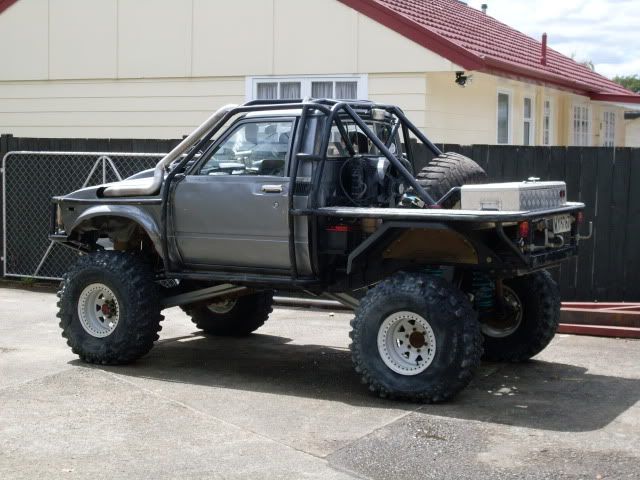

A year ago I sold my sas surf to invest the money from it and a lot more money into what is most peoples biggest asset "the home" 20grand+ spent and many hard hours of grafting and Sept 4th quake has written it off, so 7months with nothing to do at home and fishing isn't that exciting........may as well go back to 4-wheeling :P
So decided if I was going to get back into 4x4 I wanted something that goes hard, well built, is SAFE (as can be :? ) and I don't need the hassles of a road legal vehicle.
One thing that bothers me is I haven't built it myself...but I just don't need the hassle of a truck build and a house build at the same time :shock:
So a 2day 1 night roadtrip from Christchurch to Palmy north and back to Christchurch, I picked up this (and trailer) which will get a few further mods eventually on this thread, firstly tho I'll have some FUN and get used to it :mrgreen:
Intended use:
Favourite stomping gound...West coast area, from haast to Seddonville, the odd event like Sheffield, pucker park, etc.
Maybe the odd Canty spot like Worsleys.
Intended mods;
It needs a winch, II alrerady have a Warn 9000lb low mount virtually brand new, looking at either front mount or mid mount.
Future mods, Coilovers, 4.7 gears, and anything else i find needs altering :lol:

Think you'll like the specs Grant,
Chipped 5l injected Commodore (rebuilt) mounted as far back as poss front of engine nearly in line with front axle, baffled rear sump, TH400 B&M shifter,
trussed and strengthened front housing, wide hubs, lockright and 30 spline longfileds (inc longfield hub gears), SNR hi steer, IFS p/s box, 3 link front end.
4 link trinangulated rear end, wide axle, discs, LSD (will replace with lockright), 4.8 R&P's, Chassis fully strengthened, braced and gussetted, All other heavy bits (Radiator, surge tank, battery, spare have been mid mounted, tripple trans coolers (one in radiator), headers, 3inch exhaust out passengers side, 36inch ET's on beadlocks, Real strong EXO which is fully gussetted..... lots of other nifty little mods as well such as ecu in glovebox.
The pic is the only one I have, (was taken by owner), got it home last night put to bed in garage will get some more pics soon.
Good flex but could be vastly impoved with coilovers.

Well 1st modification is on the bench, I've got a virtually brand new Warn XD9000 winch off a 2010 Ford Ranger 'quake victim'.......yes I f'n paid for it :lol:
The question is do I bother mucking around with a mid mount set up so I can winch forward or backwards....... or just mount it up front :?:
If I mount it up front it will still fit well back in the engine bay where the radiator was, I think it'll fine there........at least for now :mrgreen:
Who i'd really like an opinion from is someone who has dabbled with a mid mount, and has some advice on them, i've had several mounted up front and well rehearsed with one there :wink:
