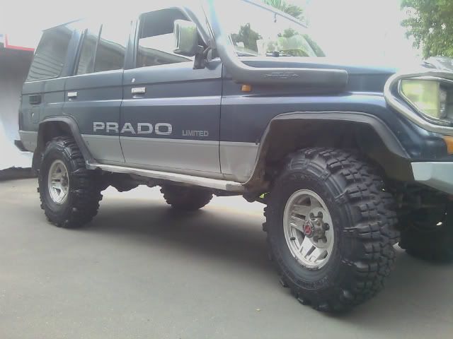

Well it took a while but I finally picked up a set of Simex JT 2, near new with white spokes for $1400. Pretty happy with that :) Rims didn't clear my brakes tho so had to get tyres change on to spare rims I had.
Tyre whine is a bit like a plane take off - was pretty cool on the way home but might get old on a trip to coast.
