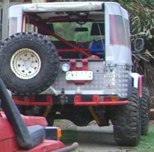

I havent got any lux pics but I've got a pic of my 40 with 10" rims (-44 I think) and 50mm wheel spacers

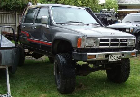

Best pic I can do atm, the rims are 15x10 -44 offset with 33x12.5.

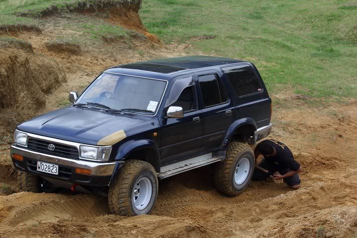

this is the best i can do,these are 35x12.5 on 15x10 -70,from memory theyre about 2-3" max out from guard so im pretty sure youd find yours will be under or on 2" which is pretty normal
