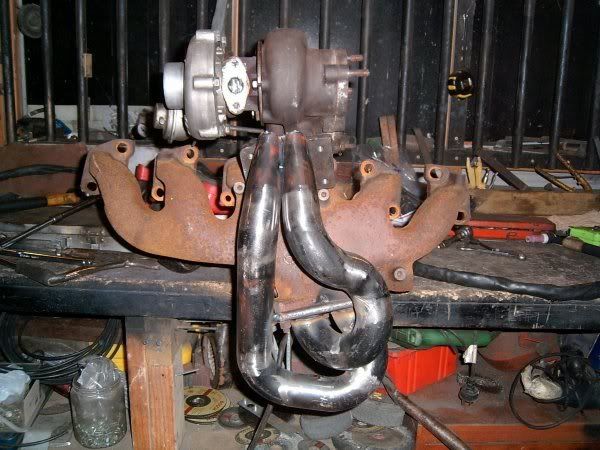

buy a manifold, make sure it suits your turbo. whack it on, mod shit to suit? midas would be only trusted to mod your dump pipe and exhaust if required and you can't do it yourself. the rest, pending mechanical ability or an apititude to learn as you go = DIY?
edit: beaten.
FWIW i saw this a whie back.
easy/cheap way of getting a high mount turbo setup?
seems to work, too.
edit: beaten.
seems to work, too.

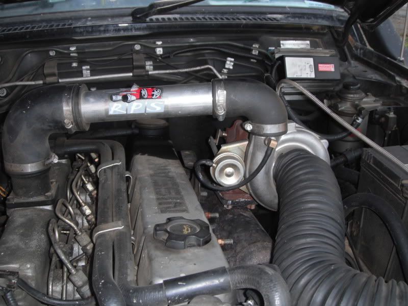

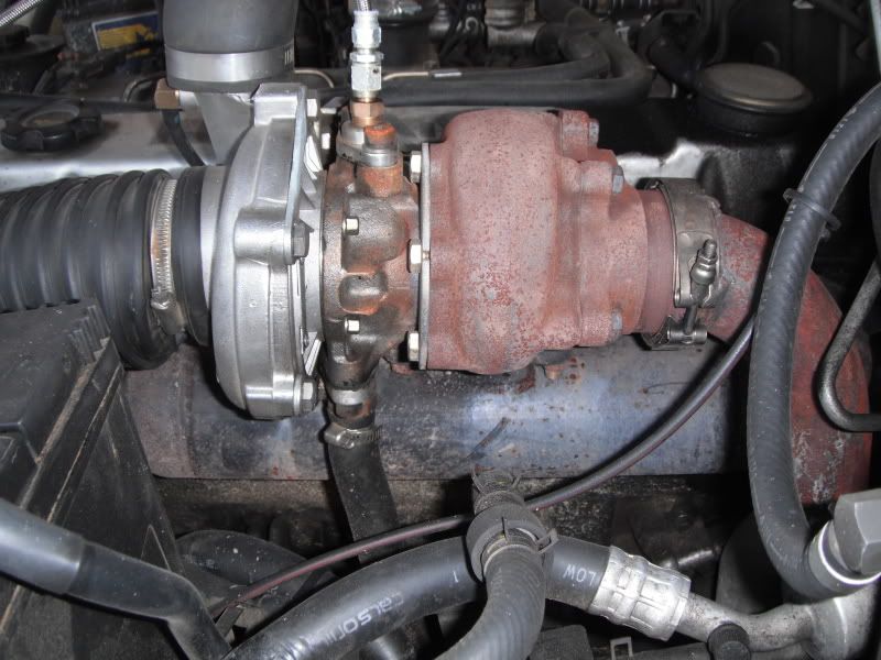

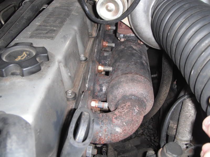

Re: Sick of it....time for options
Pictures of the current setup

So new manifold, 15 -16psi, intercooled and run egt's of around 500*c will make for a very good reliable tow wagon. It will also go very very well! Don't go to high with boost or EGT's as towing you will really stress the motor.
Is your truck auto or manual as either way you'll need to do some work to cope with the extra power and towing.
Manual needs a new extra HD clutch and the auto will also need new clutches installed.
For the auto you want VH45 clutches fitted to it and a shift kit for the valve body. This does require the auto to be completely disassembled and will mean it gets a complete overhaul but will then mean it is good for lots of hard work and 300,000k's more abuse.
FYI, If yuou have a turbo TD42 and you are towing heavy loads then an exhuast temp gauge is not optional! You also need to be aware that the highest egt's happen at lower revs before the turbo is fully on boost (normally) and when towing this can happen a lot. You can't rely on the water temp to see if the truck is running hot as it takes to long to respond and so damage can already have happened.
A cheap reliable way to make a manifold is to use weld bends and tee with heavy wall steam pipe.
As for the VH option, I have one and unless you have a big cheque book forget it. I did it all myself and it was still many thousands but it does have huge amounts of power, more than any TD42 is going to get. (but I did turbo mine as well)
