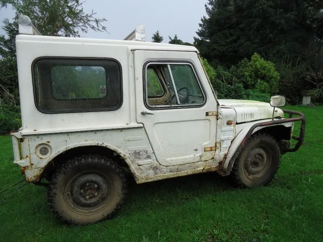

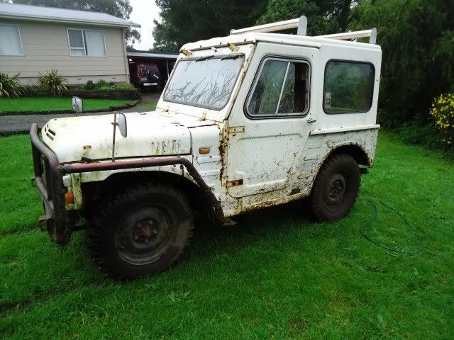

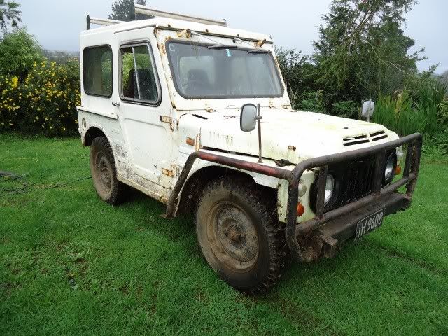

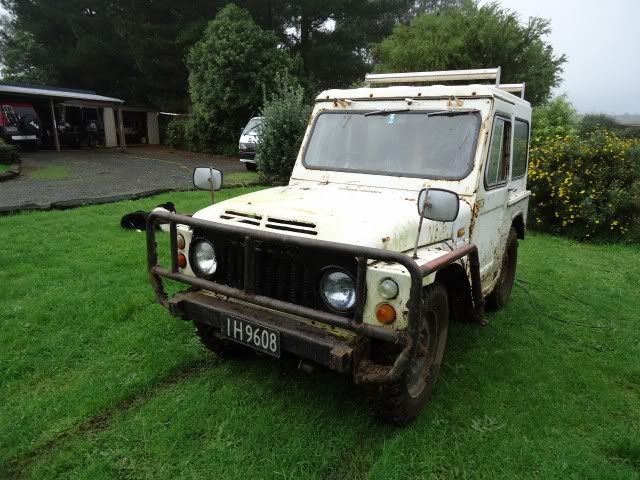

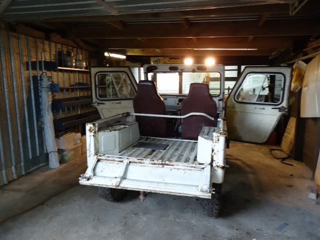

So this is what we are starting with:

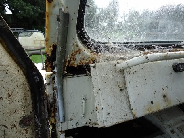

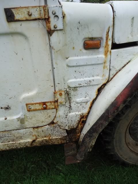

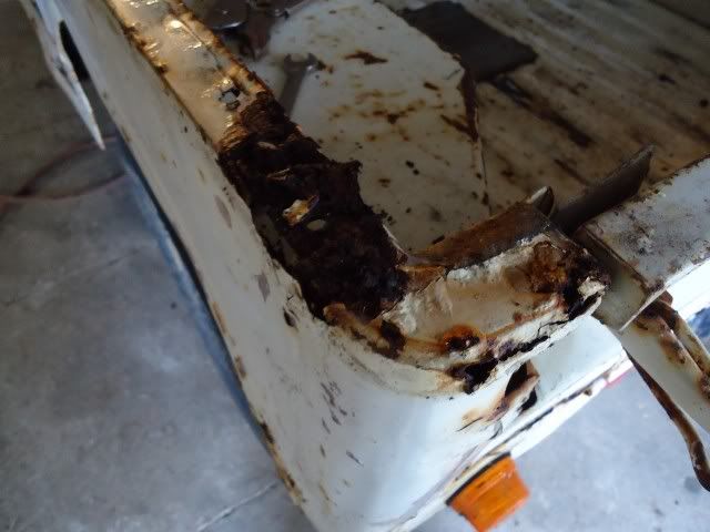

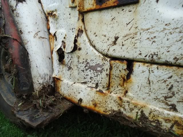

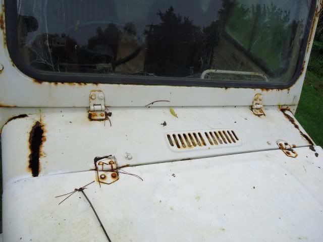

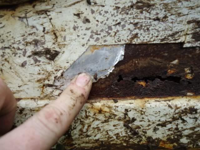

Did you know Suzuki's are Biodegradable??

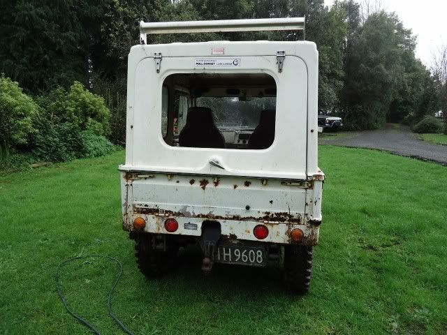

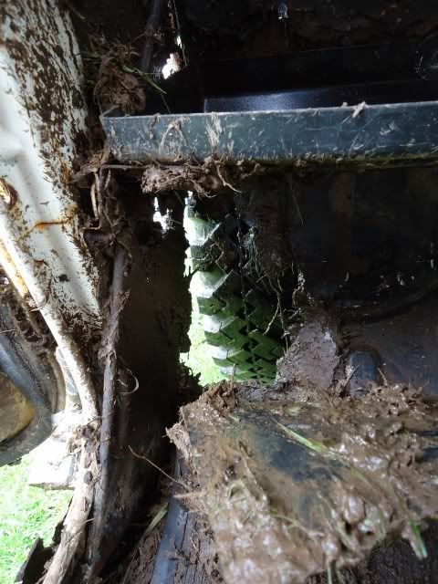

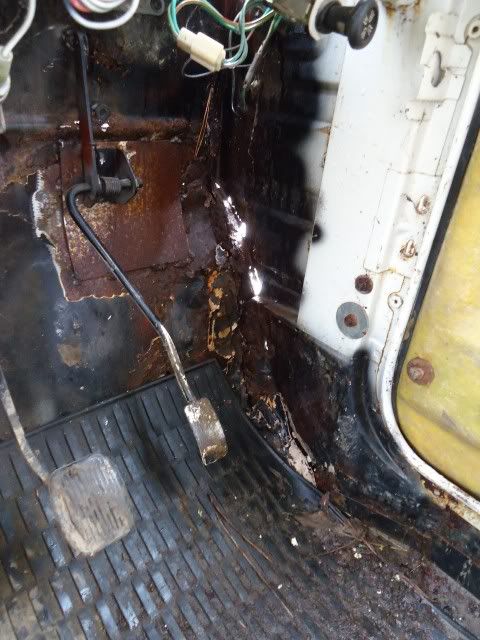

Don't believe me?? I'll show you:

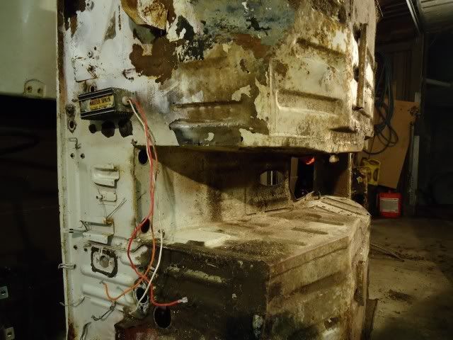

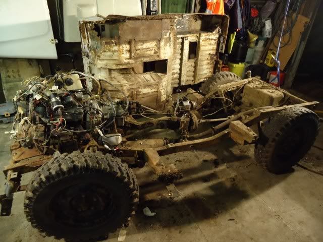

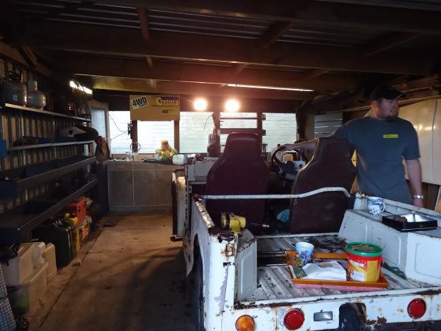

The work began at the weekend. The stripping has started:

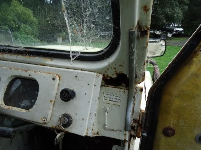

Some more bio degradation under the canopy:

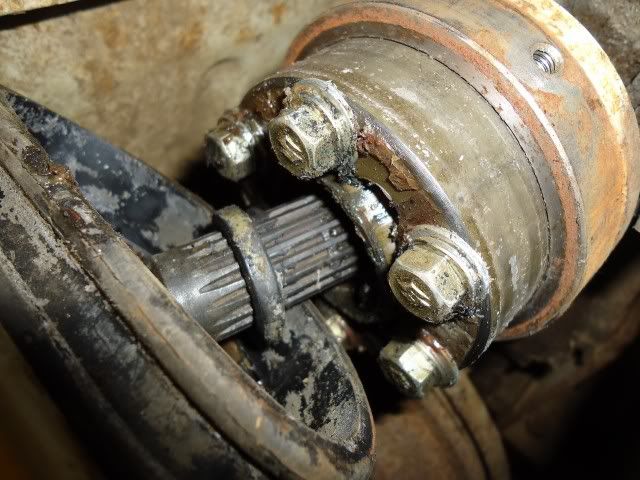

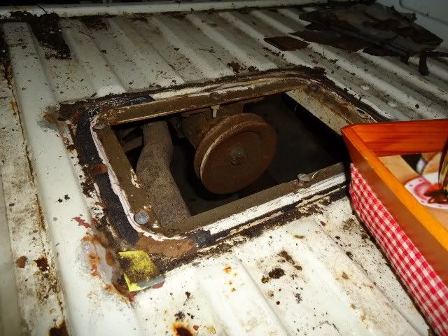

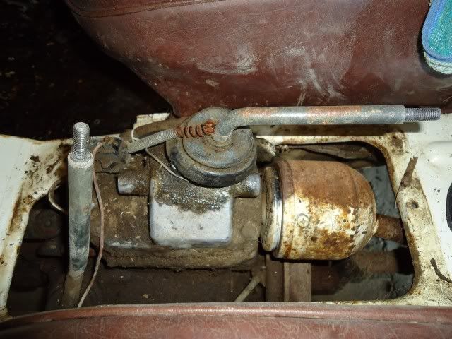

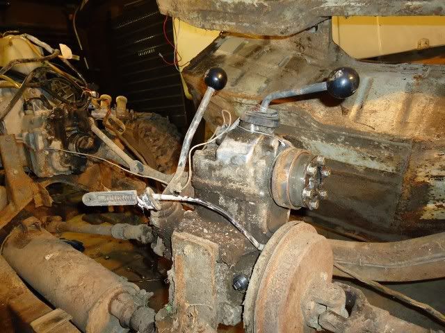

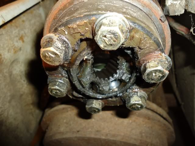

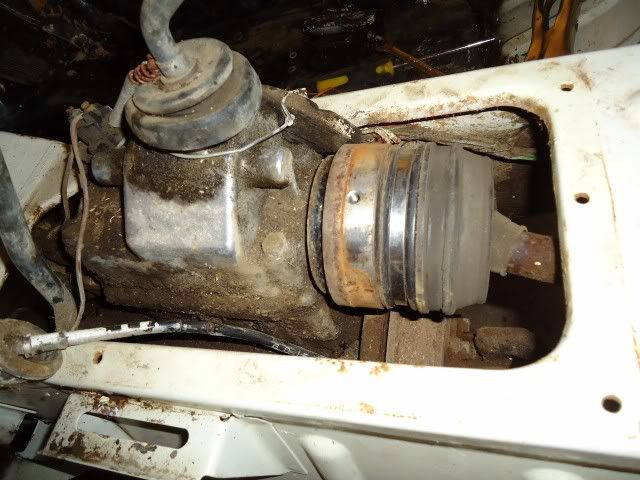

I ran into a snag when I couldn't figure out how to disconnect the PTO shaft from the PTO box, as it runs through a hole in the body work. So I took some pictures of it in stead.
PTO Box on top of the T.Case:
PTO with steel sheild removed showing CV joint and rubber boot still in serviceable condition at this end:

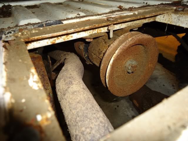

PTO drive end of the saft with V Belt pully
I reckon I could run a little GM power steering pump off it and power the smallest hydraulic winch I can get my hands on :lol: :lol:

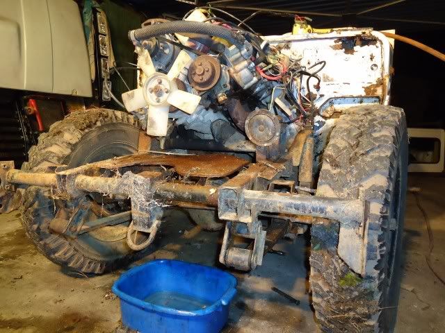

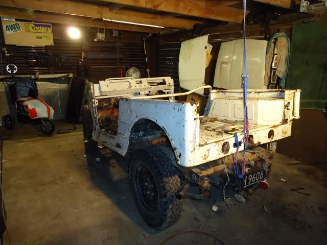

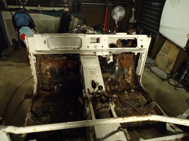

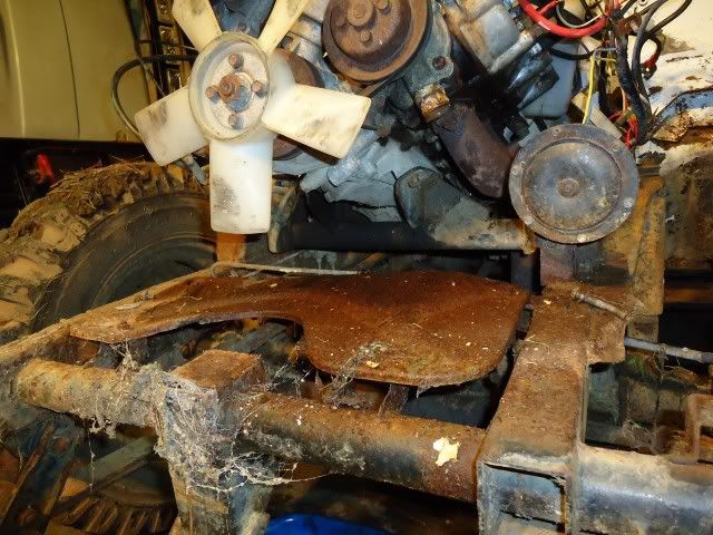

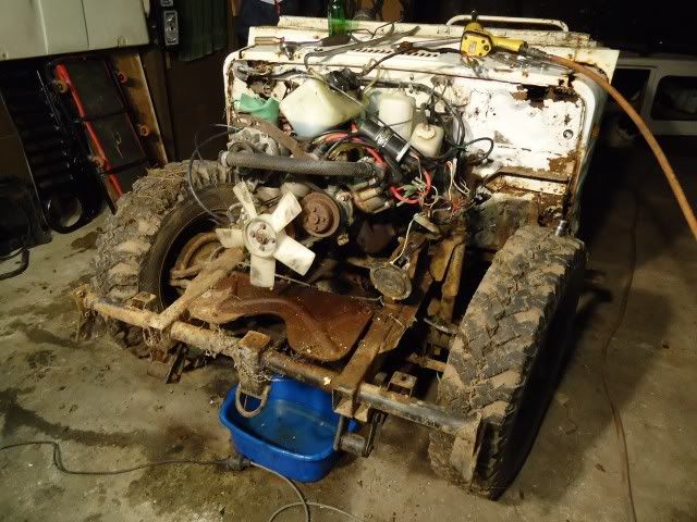

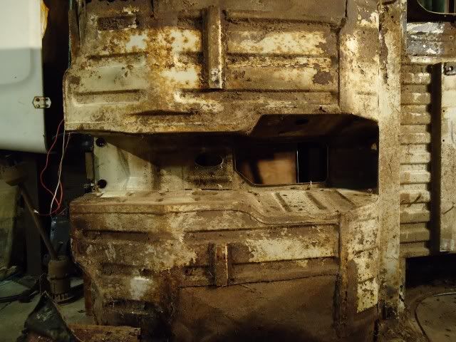

Been hitting it hard this week, lotsa rusted nuts and bolts, dirt, rust flakes and cuts from jaggy rusted edges, but progress is good :D
Don't quite know what I would do with out a rattle gun, angle grinder and BFH :mrgreen: :mrgreen:

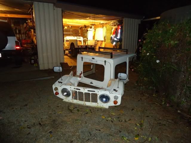

Popped the front clip of and dumped it out side:

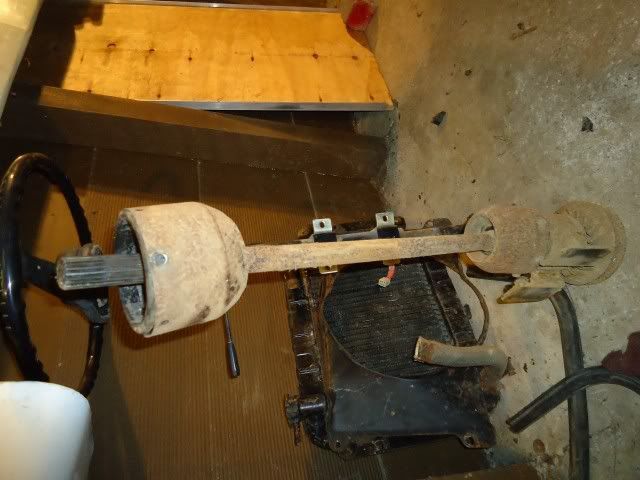

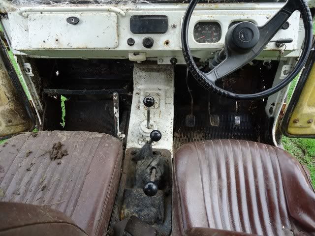

Dash all stripped out and de-loomed:

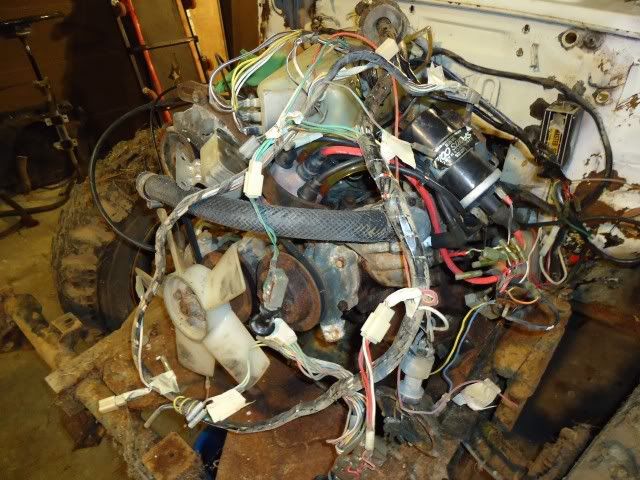

I thought a couple of pic's of the engine might be interesting. It sits high in the chassis, even more so as the motor doesn't have a sump like most people are used to seeing:

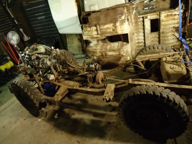

The Tub is free, finally got the last rusted body mount bolt out :lol:

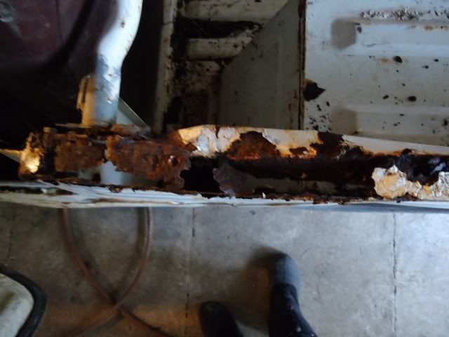

Rolled the body off to the side for the first real look at the chassis. Looks GOOOOOOOOOOD, i'm stoked :D :D

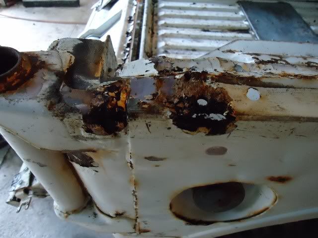

Some awesome rust holes in the floor pans!!!
Good news is the trans tunnel and fire wall are good. With those two parts, the rest of it will just drop right into place :P :P :P
Just for UBZ, some PTO pic's:
The Front PTO CV joint
PTO on T.Case
PTO shaft and rear housing
And for Mudslut, the bloody shaft came straight out of the joint, no circlip or nothing. So much for our removal cross member mod :lol: :lol: :lol: :lol:
Water blast is up next :mrgreen: :mrgreen:

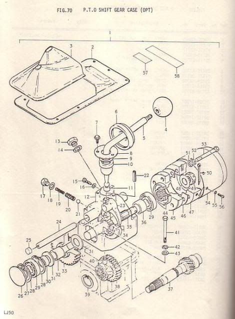

I think it needs to be opened for a more detailed inspection, to see what ratio the case is :wink: :wink:
and to see if it is copyable....... :twisted:

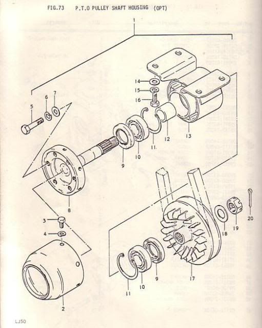

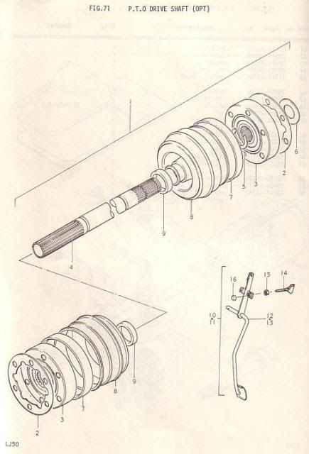

Check my thread on Auszookers, some dude posted a exploded diagram of the PTO :D
