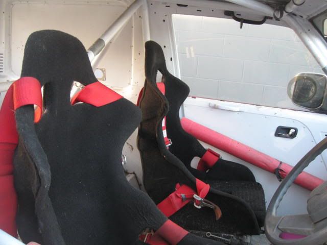

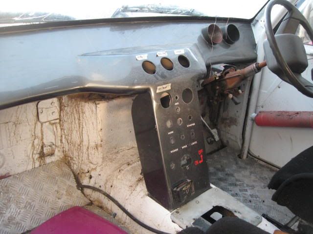

Custom dash :D

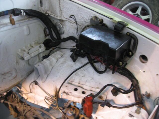

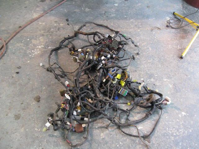

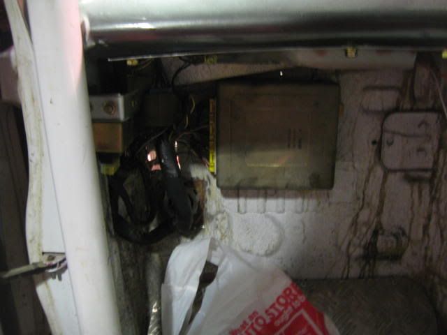

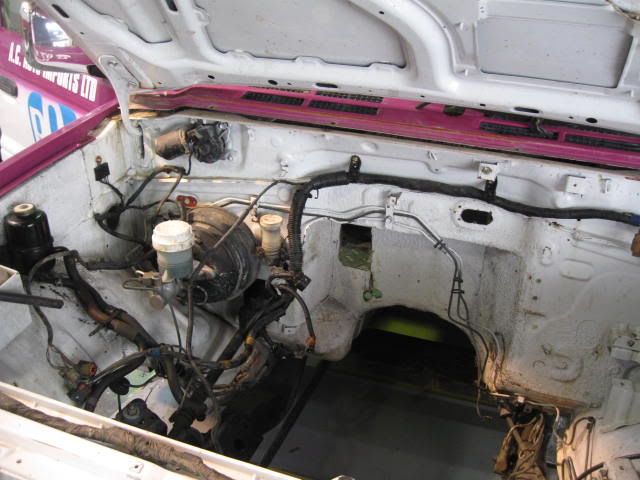

Big day today on the truck,spent a couple of hours down at bryant rd dismantlers in the donor paj removing a wiring loom from the engine bay and behind the dash this is what i ended up with
While its lay out was still fresh in my mind i fitted it straight away
i will get the auto sparky i use to go through the under dash part of the loom on monday to see what we can get rid of

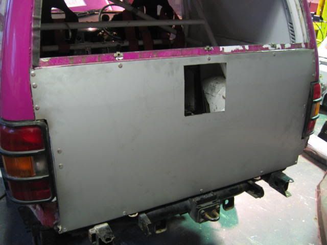

Then removed the flimsy bent and streched alli rear panel and made a new one out of panel steel

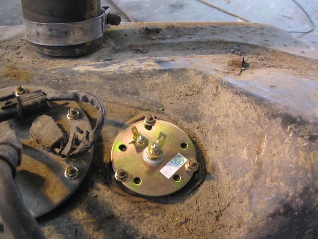

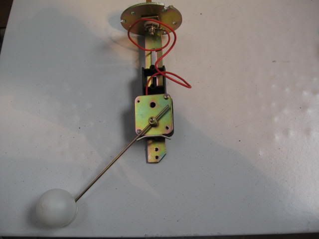

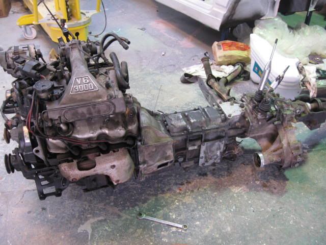

Got the motor and gearbox for the truck this week
Today i got the spring platforms welded on to the chassis and diff
Then i fitted the fuel sender in the tank for the aftermarket fuel gauge

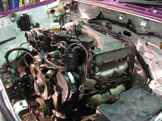

Update time,motor and gearbox are in,clutch is all bleed up,i forgot to get pics of clutch before i fitted it,im runnin a 6 puck brass button clutch plate with a mazda RX8 H/D preasure plate.While i was playin with brake fluid and had the asshole of a one man bleeder out :evil: ithought i might as well do the brakes at the same time,great fun me and the workshop floor wore more brake fluid than the clutch or brake system :lol:
Got the internal wiring tidyed up

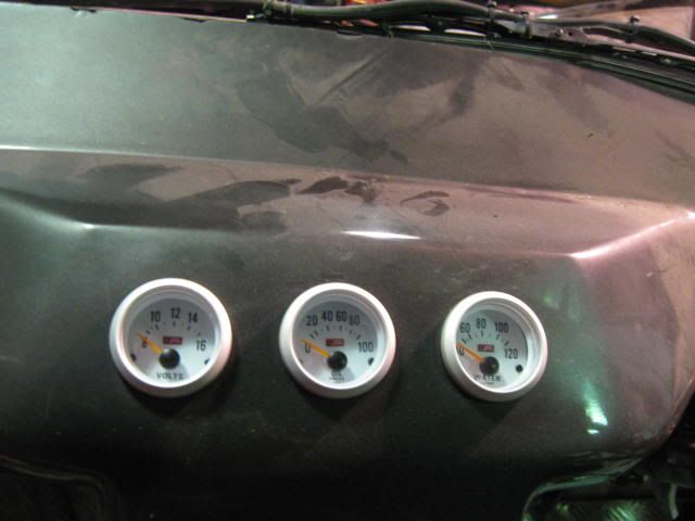

Fitted new steering wheel and started on the gauges

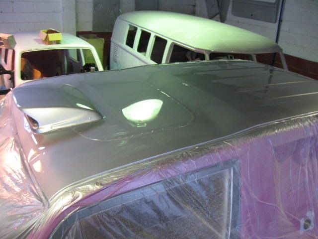

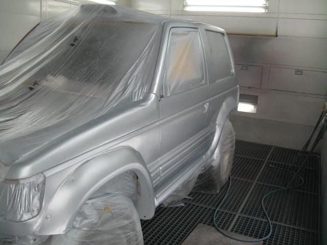

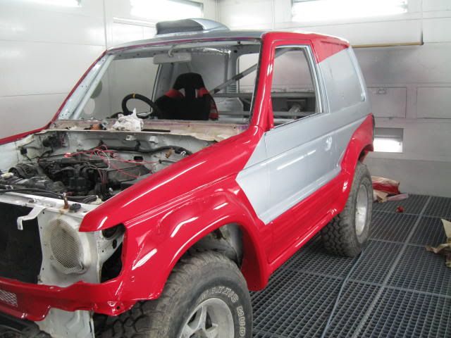

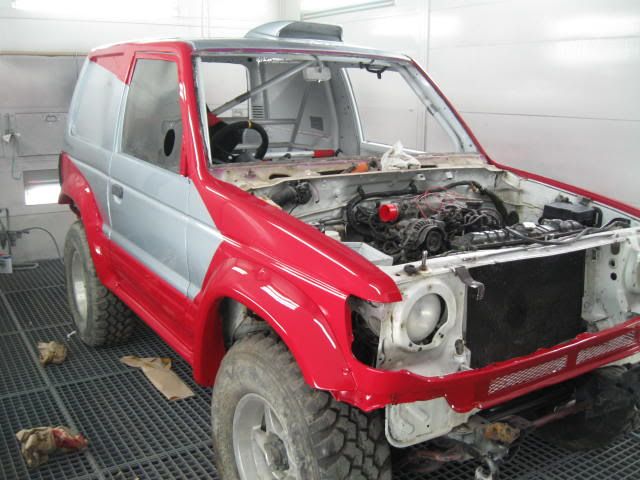

Update time

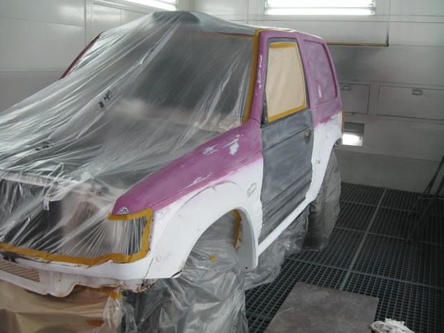

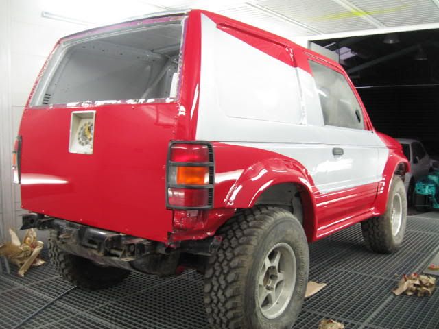

Wednesday night i painted the roof

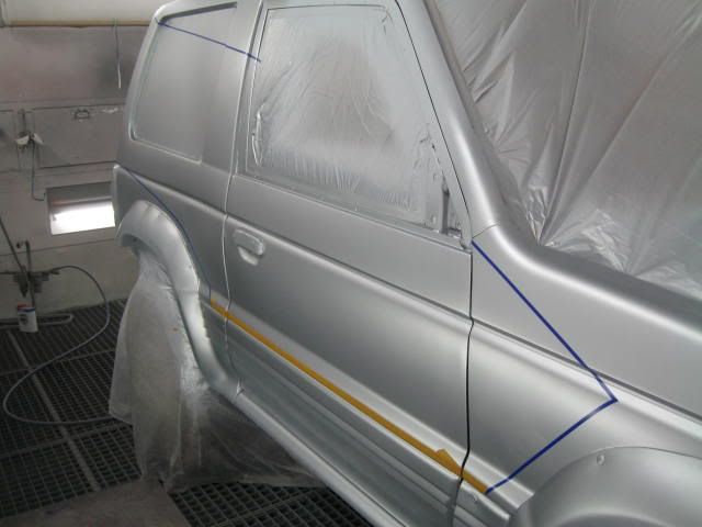

Today i painted the rest of it.Masked up
Silver sprayed

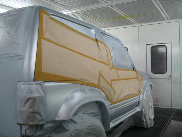

Mask out the silver that will be kept
Then applyed the red,then removed the paper covering the silver and then applyed the clearcoat,baked it then wala
