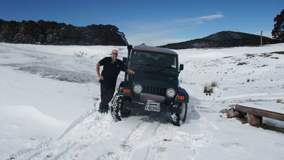

Good on you ..Back From Canaan,bloody amazing snow every where..mines a hard top,definitely worth having i reckon and personally wouldn't worry if you got an auto if you found something you liked that was tidy...I was like you and only wanted a manual but my Wrangler was that tidy and a good deal [ it was a ladies shopping cart ..lol.. ] that i bit the bullet and bought it with auto,know regrets what so ever so far ..but in saying that a manual would also be great ..you will love it..

furnace wrote:canaan this afternoon
nice jeep, tidy winch setup!
