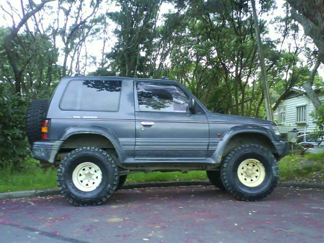

madlux
Posts: 199
Location: west auckland
Re: Strong IFS
Post by madlux »
had a 92 running 35's. I fliped top ball joint and used a spacer to reduce having to crank torsion bars but still had outter cv's problems, also had a 50mm body lift to help clear 35's but if i was to do it again i would just do a bigger body lift and keep torsions near factory height.
