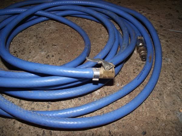

not sure if your meaning just the hose and nozzle/gauge or a complete pump?

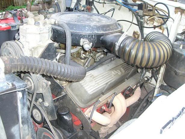

I've tried a few different things and just use a hose kit you get from ARB (came with my first set of airlockers), its just a straight hose with a clip nozzle on the end without a gauge, the advantage is that you can clip it on and dont have to piss around holding a trigger while the tyre inflates, after a while you get pretty good at judging the time to inflate the tyres and only need to do a quick check with a gauge and a minor + or - adjustment of air. I've got an A/C compressor on my 40 series to supply air and it pumps tyres up pretty quick, my flatdeck only had a ARB compressor and I only really used that to put a bit extra air into the tyres untill I can get them pumped up properly, there a bit expensive to wear out pumping your tyres up every 5 minutes so I always knew whose truck to park beside to get my tyres pumped up at the end of a trip.... aye Reece

Sadam_Husain wrote:not sure if your meaning just the hose and nozzle/gauge or a complete pump?
I've tried a few different things and just use a hose kit you get from ARB (came with my first set of airlockers), its just a straight hose with a clip nozzle on the end without a gauge, the advantage is that you can clip it on and dont have to piss around holding a trigger while the tyre inflates, after a while you get pretty good at judging the time to inflate the tyres and only need to do a quick check with a gauge and a minor + or - adjustment of air. I've got an A/C compressor on my 40 series to supply air and it pumps tyres up pretty quick, my flatdeck only had a ARB compressor and I only really used that to put a bit extra air into the tyres untill I can get them pumped up properly, there a bit expensive to wear out pumping your tyres up every 5 minutes so I always knew whose truck to park beside to get my tyres pumped up at the end of a trip.... aye Reece![]()
pretty much what im after ay, sick of kneeling down holding it on, were did you get that clip from and would i be able to put a gauge just behind the clip to see whaat presure its at? was hoping there would be a standed one with a clip type and gauge in one.

JR wrote:pretty much what im after ay, sick of kneeling down holding it on, were did you get that clip from and would i be able to put a gauge just behind the clip to see whaat presure its at? was hoping there would be a standed one with a clip type and gauge in one.
they sent me the whole hose with the fittings with some air lockers I got from the states a few years back, problem with trying to stick a guage on without a trigger is you'll end up reading the air pressure in the line instead of the air pressure in the tyre
JR wrote:have tha a/c pump feeding a holding tank in the front bar, so hopfully is not to slow, also as said useing a grinder or such in the bush will be vary handy.
the only problem I had with my A/C Compressor was the inlet was too restricted, I replaced it with a length of heater hose into the cab with a filter on the end and it made a huge difference to the air flow and volume
