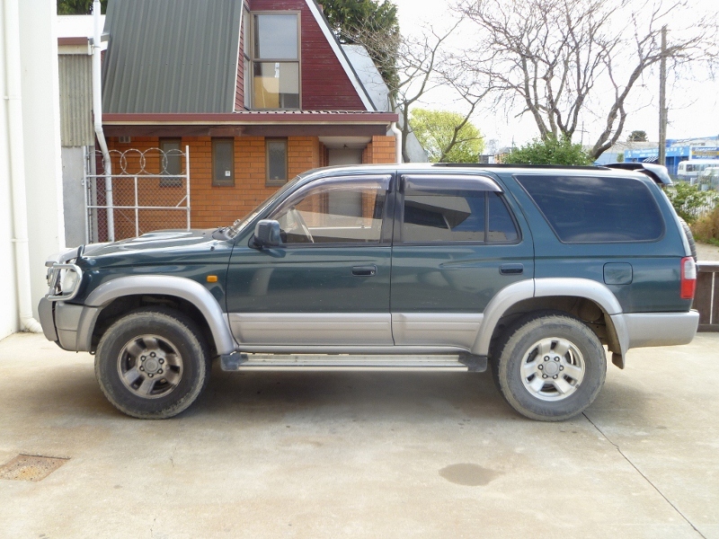

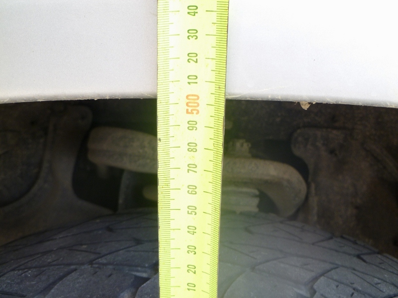

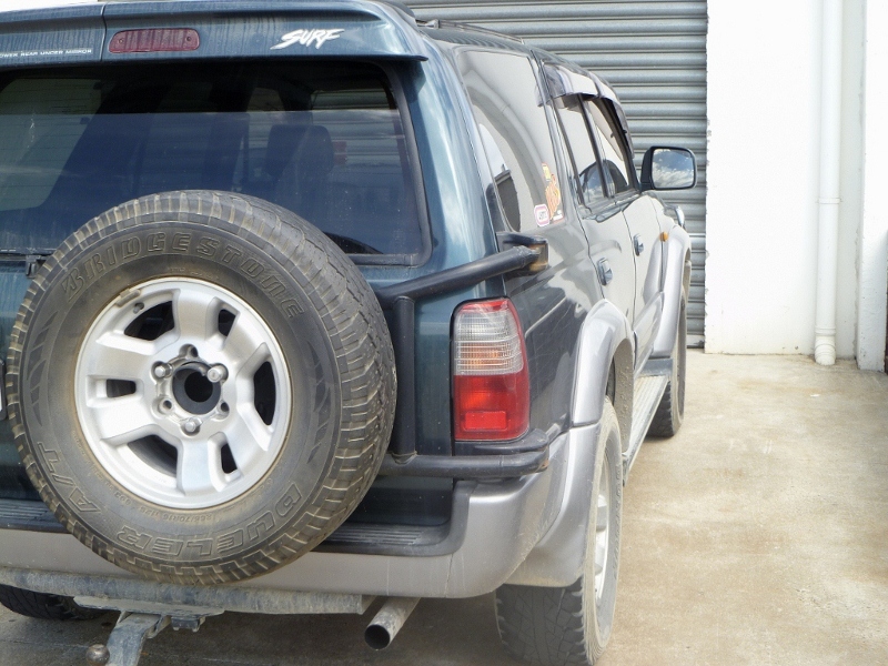

Re: VVILLY TONKA-KZN185
Well i thought i would put some pics up of the truck before we started to molest her, so took a couple.

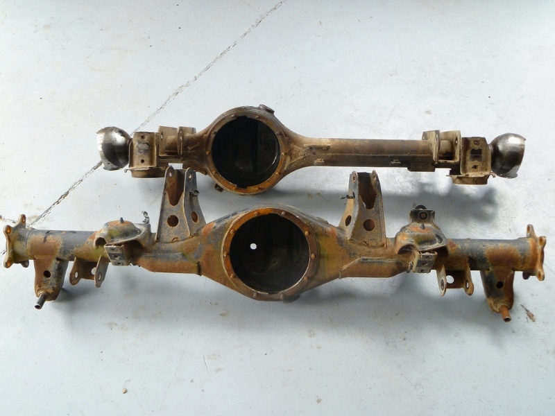

so today i stripped the diffs and degreased them ready for the plasma on Monday
and then cracked the transfercase of the transmission and it pissed out shitloads of water so not risking it.... anyone got a spare 1kz transfercase out of a kzn130

well today Rick and i went out and brought a plasma/ tig AC/DC combo.
Once set up and sorting out the 20 amp plug off i went.
Cut all the brackets of the front diff housing and ground back all the left over welds. Also removed the top panhard mount off the kzj78 chassie.
Doesn't sound like much but bloody hell its time consuming
