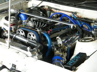

theres two main 2l/2lt series. they have different heads and i think the exhaust manifolds are different. early ones are roller rockers and later ones are shimmed type.
plus i think early 2l's didn't have oil squirter's etc so they are not good for turboing.
i can't see the point of putting a 2l back in there, gutless and only going to blow heads.
if you are going to change engine shove a 3L or 5L in there. if your 2LT is the later type the turbo gear will all bolt on. tho check the turbo, those motors are very old and turbo is probably on its last legs.
