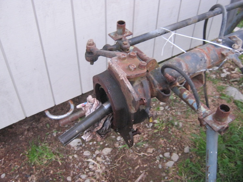

Hey Guys

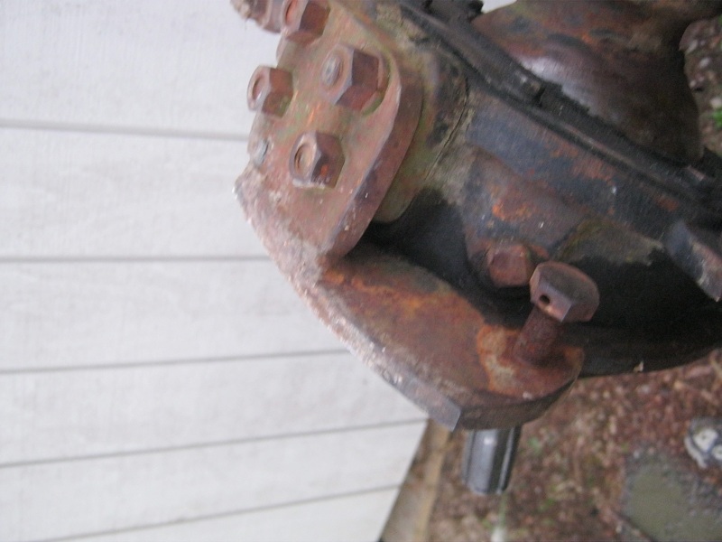

I brought this diff off trademe with intension of doing a disc brake conversion on fj40 after trying to get the right parts and then finding out from guys at toyota in lower hutt that its an early model 3 speed thats been converted and also has the old course spline cv and may not get a cert because of welded steering components. Toyota guy been very helpfull , told me to take it to Ken McAdam for advise but havn't made it there yet. Does anyone here know if it would get a cert?
Thanks Shane

welded steering components wont get a cert..
sorry bud..

ok bugger :(
thanks Ill keep looking around for another one now at least i know what to look for now :)

Even if you get rid of all the stuff on your diff and replace it with 60 or 70 series components your still going to have a problem with cvs. Your diff has the early smaller coarse spline cvs and if you converting to 60 or 70series gear you need the later fine spline cvs which are bigger and dont fit in your early housing.
But you can make the fine spline cvs fit by clearencing the inside of you housing to suit, Ive used an air belt sander in the past because they dont need much.
Or the other option is get a later model 40 series diff housing that uses the fine spline cvs. :D
