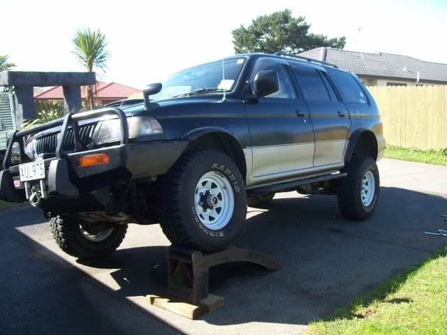

Hi Waypa here.
The picture is of my truck. The adjustment of the sway bars is very easy to do. You only need to do a ball joint flip if you use up all the travel space.
Yes Challengers do have a tendancy to tripod rear wheels, however I don't think this is any worse than most Surfs I have seen.On extreme articulation at the rear the body can move over considerably. This did have a tendancy to break the heads off the shocks. I had also removed the rear swaybar and this allowed the body to move over. However the problem of the broken shocks was fixed by our club engineer Bernie
Konz and this was a very simple fix. Yes a rear locker does transform this vehicle. If you have a towbar the fitting of the rear towhooks is quite simple. If not they can be attached to the chassis.
The front towhooks are another problem but not insurmountable. You would need to look at what Coxy has done to my truck and I have seen others with towhooks fitted front and rear.Wider rims do give you a better track. Off Road Australia forum has a section for Challengers. These trucks are used quite a lot in Australia.
Yes this has been a 3 year learning curve in NZ, but don't let this put you off. I have done the hard yakka now and you are more than welcome to view my truck and discuss modifications and /or problems etc.
