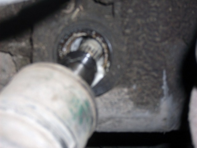

ive just been doing a bodylift on my suzy and putting 5 dr springs in it but ive managed to pop the drivers side cv out of the diff and not sure how i am ment to go about getting it back in do they just back in if you take it of the hub or is there another way ? any help be good
It should just push back in, there's a c-clip on the end of it that should enguage and make it a little difficult to pull out again. Be careful you don't pinch the seal on the way in! Is your oil white? If it is you might want to change it.
