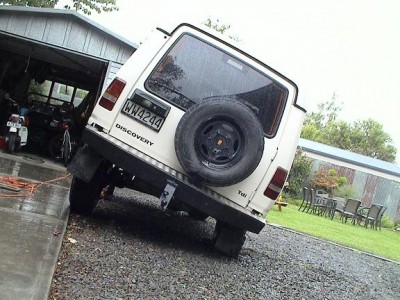

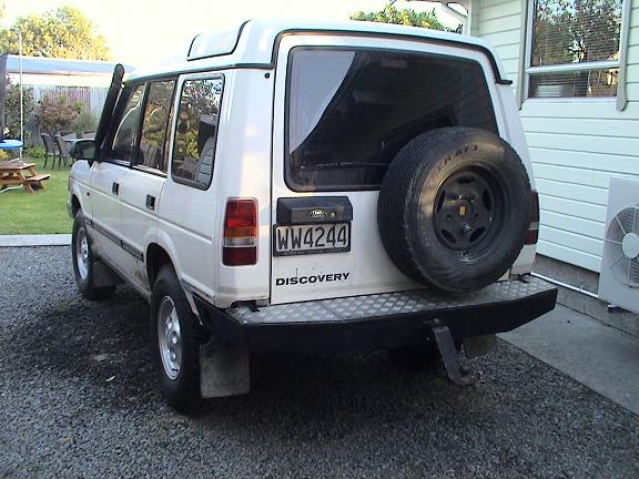

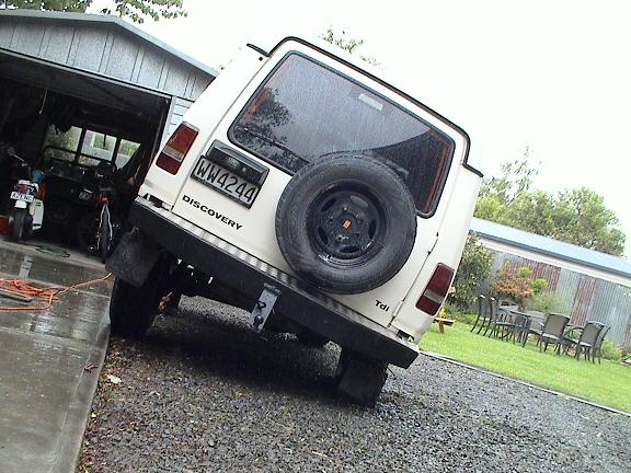

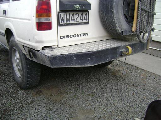

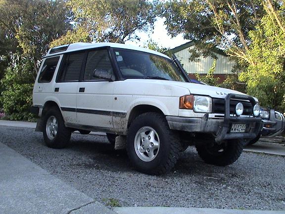

alright pics.
rear bumper is quite a tank of a bumper.... but does the trick.
the guy i brought the bumper off had a v8 with the same size tyres. he had just done a 2 inch lift and measured same as mine. ( measured bottom of rim to top of guard). so may have had lift already.

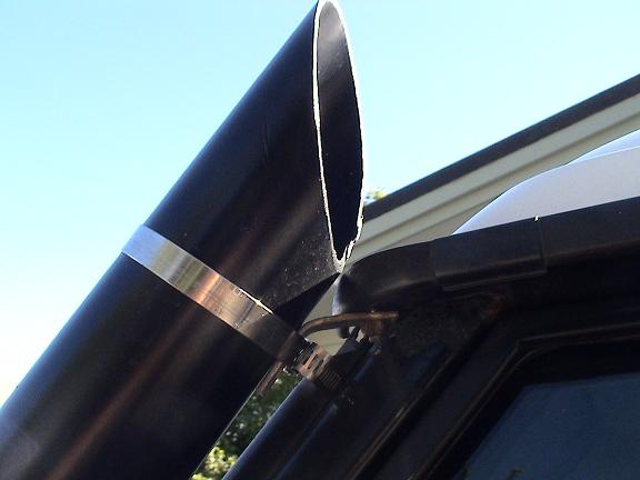

will be cutting snorkel and putting top hat on in next week or so.

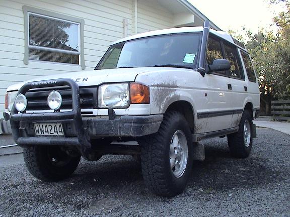

cheers yeah hoping to get some mud on it soon as. wanting to join cloc. just havnt had reply from them yet. as can seem to down load form....

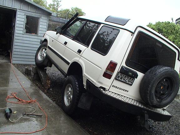

few more pics. had rain day off work so wanted to sort out the little rub it had when full flexed.
amazed as how much better this truck is than my pajero.......
had all mufflers removed and exhuast put out through bumper now.
bit noisy but got a free flow muffler to go in. def seems to spool up quicker now. ( should do as old mufflers were factory and shes got over 300000k now.
and just tonight plumbed waste gate to inlet manifold so engine now getting factory 14psi at head. goes much better even more so after i played with injector pump.(not main mixture screw just boost inrichments)

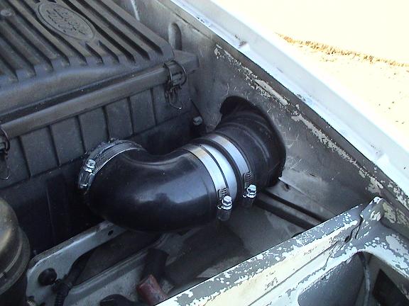

hiya, any chance of a photo of where/how the snorkle is plumbed?
Cheers - Mark

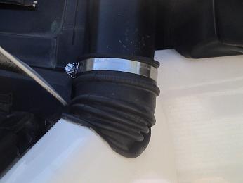

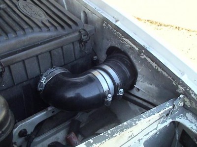

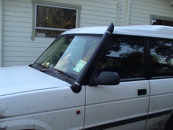

hi mark
yeah no worries. i had to pull off front guard to fitt up. wasnt hard bout 3 hours all up gettin it to work.
under guard is a box channel spot welded to body. i had to remove because of running 3 inch pipe to fitt between guard and body.
you really only need 2 90 degree bends and 1 45 degree. some pipe and hose clamps.
air box has drain holes that have to be sealed up. i know mine is water tight as can put hand over snorkel it stalls the truck and holds suction on.
just drilled lots of small holes and filed out
how i held it up the top

thanks for that. Not quite the setup i was hoping to be able to replicate. There are some (apparently) set up straight below windscreen through a reasonably wide vent panel between screen and bonnet. Need to get a gander at one.

xj wrote:thanks for that. Not quite the setup i was hoping to be able to replicate. There are some (apparently) set up straight below windscreen through a reasonably wide vent panel between screen and bonnet. Need to get a gander at one.
You maybe thinking of the Range Rover set ups which won't work on a Discovery.

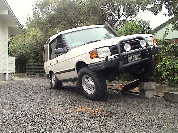

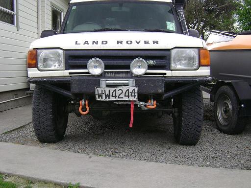

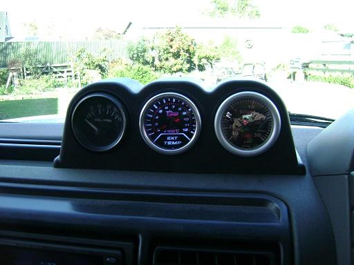

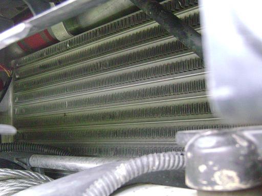

ok been a while and done a few mods to the girl. not quite there yet but close.
so far have put in full front mount intercooler. fitted egt, and boost gauge. wound fuel up and boost. goes great now. egts are good even towing. still great on fuel (unless booting it every where)
opened up exhuast
built a front bar for it and fitted winch.

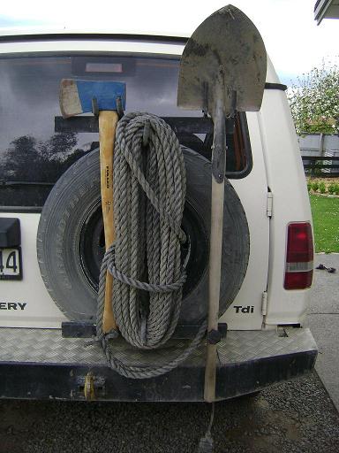

built a rear wheel rope, spade and axe holder
brought a custom rear bar and fitted.
rear diff locker ordered. just waiting to find a diff head to fit it to.
and in process of building a roof tray.
pics
