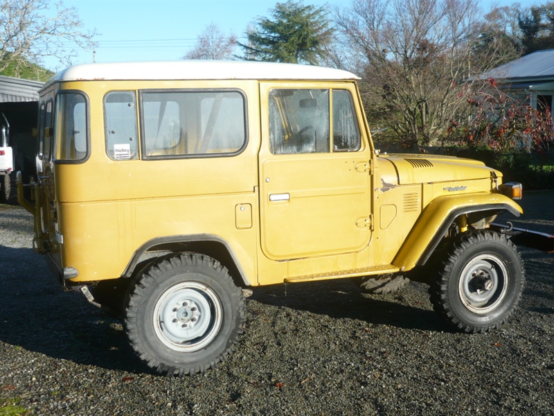

This is the truck with the ok running gear

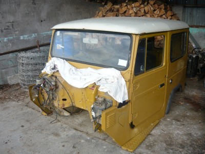

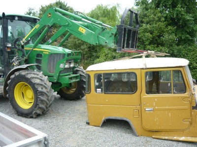

This is the truck with the ok body
Body off

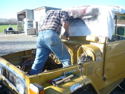

Rust killing some cancer.

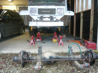

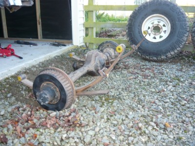

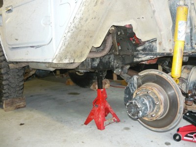

Few more pics for you guys, hope everyone can see them because i know a few people have had trouble uploading them, and im a dummy when it comes to computer stuff!

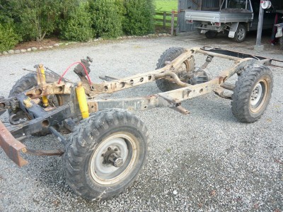

Chassis from under yellow truck
Rear axle that needs disc brakes i think
Rear out, heading to CCS (Jason) for better stoppers!

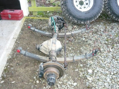

Front axle under the spotlight now
This front end has seen alot of water! (like the rear)

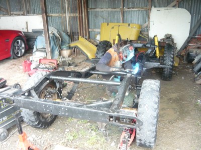

Found a few more recent pics

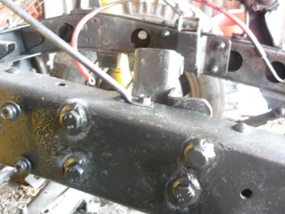

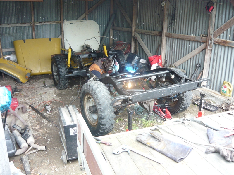

Welding crush tubes
Welding crush tubes
more welding
more welding

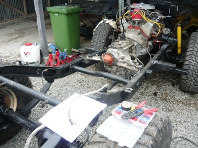

First fit up on new engine mounts

Ooooh, V8, HEI Dizzy, me likely :mrgreen:

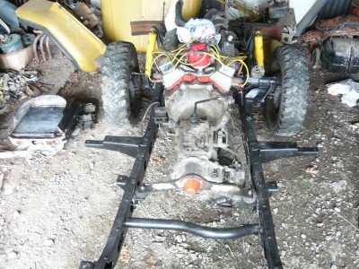

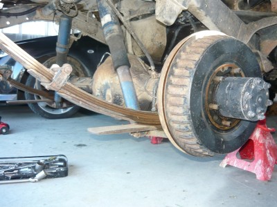

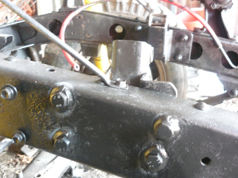

Bit more done... in the photos i was setting up with the old original leaf springs but it will have O.M.E leaves in it when done.... decided rear axle needed to move back to fit large wheels in and give me a little more wheelbase, so reversed springs which then required the diff to be tipped back for driveshaft angle, so welded new perches on axle because old ones were sloooggged out bad anyway. Top shock mount tipped round to line up with bottom mounts now...
Nearly finished engine mounts...
Doubt the chassis will crush now, 20mm tube...
Rotated top shock mount because of  spring reversal....
New spring perch for better diff angle..

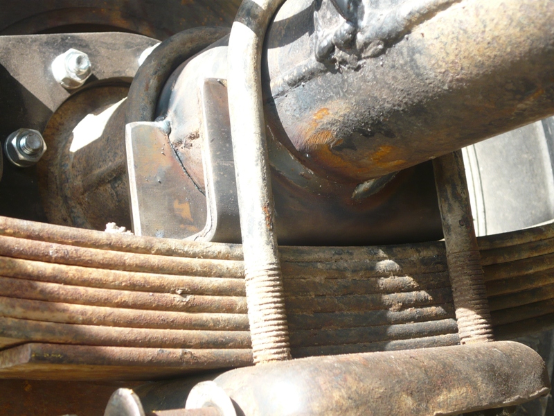

sweet fella.. have you had any thoughts about ubolt flippin her?
KROOZA
Posts: 122
Joined: Thu May 12, 2011 5:49 pm
Location: Canterbury
Re: FJ40 gets a paint job
Post by KROOZA »
Tell me more, im just grabbing any good ideas that i come across.
What does that improve, clearance??

KROOZA wrote:Tell me more, im just grabbing any good ideas that i come across.

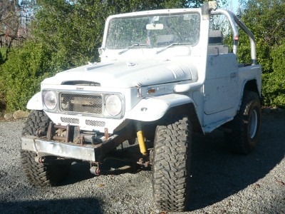

It moves the u-bolt plate from under the spring to the top of the diff Giving more clearence under the springs, suprising how much of a difference it makes especially in the front.
Ill get a pic for you of my truck.
niblik
Posts: 3307
Post by niblik »

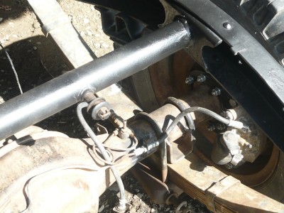

^^^exactly what he said... ya ever driven through some muddy rut area and been held up, then looked at whats done it? when in my stock styled fawdy, it was the big arsed ground anchor ubolt plates.. mint mod and easy to do while ya there...
sorta like this, but jase will chuck better pics up...

Sorry to thread jack but keen to know more about the u bolt flip, factory u bolts or custom? original plates or modded? and the shock mount???
KROOZA
Posts: 122
Post by KROOZA »
I can see how it would drag less when dropped in a rut, the u-bolts look custom? and the base plate (on top) would need a groove in it for the axle to rest in? and shorter shocks im guessing.
Your spring reversal idea has worked well Jason, its moved the rear axle back nicely to give more body clearance at front of wheel arch for large wheels.
Posts: 1259
Location: Christchurch,
mayday wrote:Sorry to thread jack but keen to know more about the u bolt flip, factory u bolts or custom? original plates or modded? and the shock mount???
The u-bolts are custom and are square not round, factory plates even in the rear and shock mounts stay the same.
Heres some pics of mine:
I run custom spring packs which are quite flat so never had any problems with the u-bolts slipping, But if you run lifted springs the U-bolts will slip and the diff will move. So made these up to sit under the springs to locate the u-bolts to the spring and stops them moving.
Hope this helps.
P.S Good to the hear moving the axle back has helped things.

Just out of interest Jason, did you make your own wedges up that are sitting under the springs in that photo?
Posts: 1259
Yes, I got two bits of plate lazer cut to size that were the thickness i needed the had them milled down to a wedge.
But you can buy standard thickness wedges pretty cheap.

Cool, i think i need to maybe just tip my rear axle back a tiny bit more, the OME springs really have a sharp curve in them where they are set.
Posts: 1259
Have a measure what size wedges you think you may need because i have some spares ones lying around here. :D

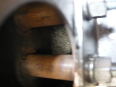

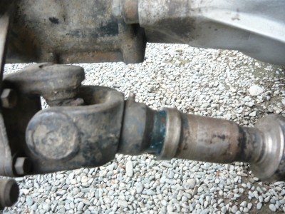

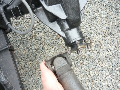

Anybody got an opinion on how much driveshaft coupling movement is needed, i guess im meaning on the flat with no flex?
I have to get the shaft for the rear shortened up but i also think the front shaft may be to limited how it sits now, couple of photos anyway.
Front shaft as it sits bolted up, no flex.
New rear shaft that needs shortening

if you could cycle the suspension it would clarify the spline mesh questions, but i'd put the driveshaft spline at about a third showing bud...

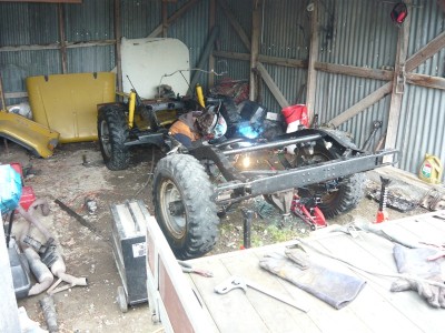

Sorting some wiring on the chassis before body going back on blocks my view
Getting ready to put body back on
