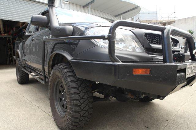

Hi there all, got a late model hilux which is set up for mostly off road and hunting, but it does some long trips to get there.
Putting an air locker in the front, what is the best option for the rear?
Air locker, mechanical locker etc?
How bad is the chattering & stuff on road with a mechanical locker?
Thanks,
