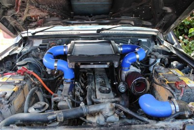

Bit slow but find attached pics of my air to air intercooler fitted.

Posts: 1846
Re: Finally fitted intercooler
Post by sibainmud »
Nice 8)
Nissan TD's respond well to this sort of mod.
100 deg drop seems to be the norm.
Good work.
HARD L200
Posts: 44
Joined: Wed Dec 28, 2011 7:37 pm
Location: Kaitaia, Northland
Post by HARD L200 »
damn thats a tidy install mate. good on ya.

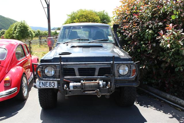

Yeah pretty happy with it. Here is the scoop.

HARD L200
Posts: 44
Post by HARD L200 »
that actually looks good. makes it look more beefed up.
