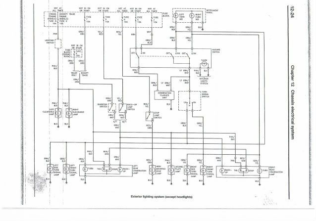

jusr realised i no longer have reverse lights...what are the wire colours from the switch so i can check or retro fit..

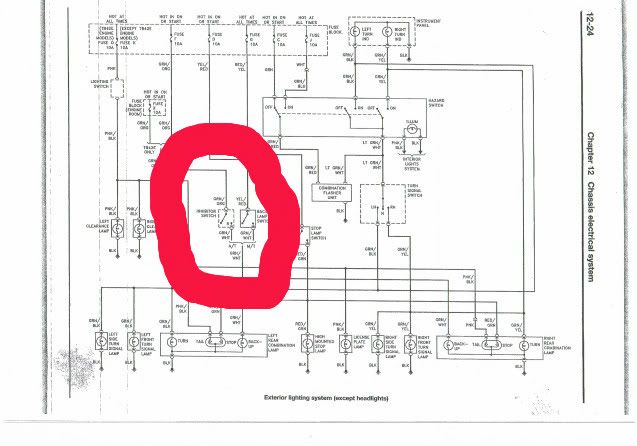

Re: No reverse lights after manual conversion on safari
yellow/red, green/white fuse

coxsy wrote:yellow/red, green/white fuse G
nice pic but cant read it, its to small..i found the 2 wires from g/box...but on my loom the 2 wires are not there..what are the wires for reverse from the auto loom that will have to be inserted ??
think your screen has a zoom :shock:

coxsy wrote:think your screen has a zoom :shock:
True it does, but it distorts writing..
f***n photobucket :evil:
green /orange green white

found it...your correct green/white and green/browny orange... all good and working..now to locate the freaking reverse beeper and make it shut up...,, cheers coxsy for pointing me in the right direction
