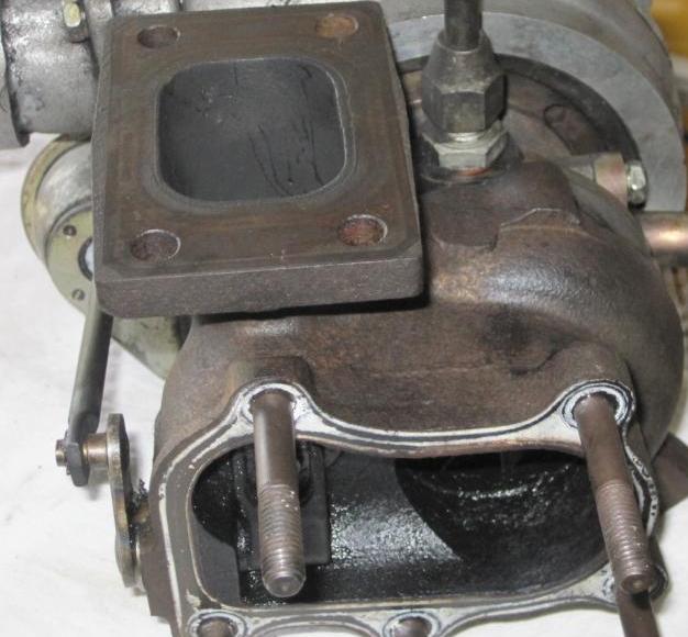

Turbo I.D
Re: Turbo I.D

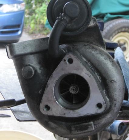

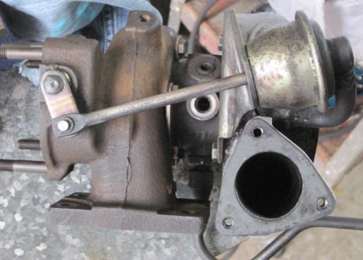

Any other pictures, compressor, side on? Seems you've loaded the same picture twice...
Re: Turbo I.D
Looks like a TD27 turbo from that side. Does the compressor housing have any plates or ID?
Re: Turbo I.D
ok found marking ,it says HT12-2.Thanks for the hint sibainmud.
Re: Turbo I.D
Looks very much the same as my spare td27 terrano turbo (1992?), which has HT12-1 stamped into the front below compressor intake.
Re: Turbo I.D
yes think you will find its a td27 from the terrano unless there is a twin out there somewhere.
