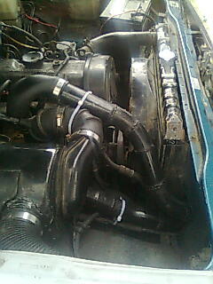

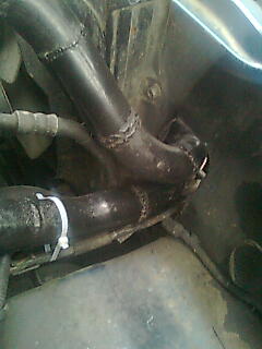

Well then what is it if im cruising through town in 3rd doing bout 1200rpm and i know the turbo starts working at about 2100rpm and i put my fut down and then nek minnit when the revs his 2100 it just goes nuts, and all of a sudden im doing 4700rpm :D and about 90 kph in a 50k zone :wink: is that boost threshold? Anyway if you want a pic of my front mount on my L200 it is below but maybe this might give you an idea. i am running 2'' pipes. the top pipe is the cold retern and after a hard drive i can put my face on it cause its not that hot, but the hot charged pipe i can barely put my hands on it.
the retern pipe going onto the intake manifold
the intercooler
the intercooler
the hole i extended to fit the pipes out. (the top pipe is the cold retern)
the 2 intercooler pipes goin to the front
