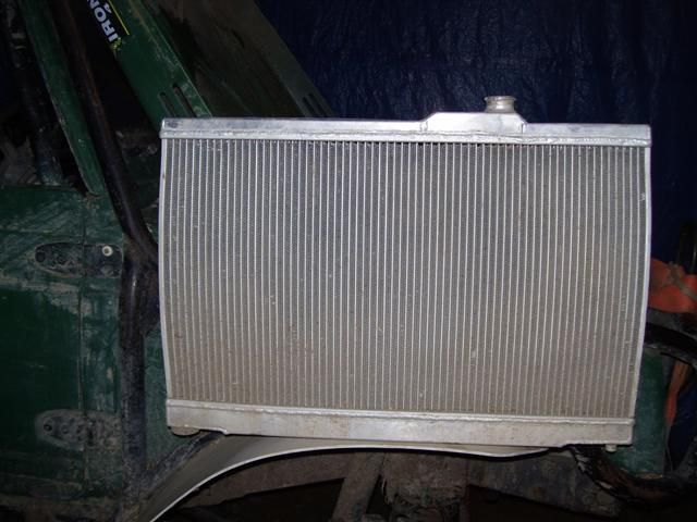

well i have struck a few other problems with my install, i have a blown head gasket and oil in the intake which i know how to fix but its a pain. better still found out the alloy radiator i have been using is stuffed, it has somehow managed to get enough pressure threw it to expand the core tubes so they are touching each other and there is no air flowing threw it. so the truck will spend a few more weeks in the shed

do you think the radiator may have been damaged by the head gasket been blown for a while? would have thought cap would have let it bleed off.? Hope you can get it sorted
Re: 2l turbo install problems
think that the rad was buggered when i got it as it has never let pressure/water out of the cap have taken a gd condition hilux 3 core rad in to ron to get cleaned and have a different size hose put on. will get it back next week. the head and manifold is going to whangerei next week to get plained. so should have it all back together in the next few weeks.u cant even see through it.

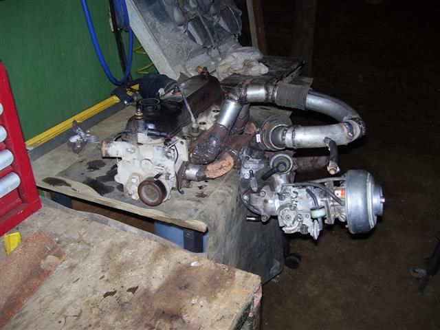

well here are some pic of the turbo head isnt on motor due to headgasket.
and yes it is totally leak proof have pressurized the tubes with compressed air and squirted soapy water all over the manifold.

new2zukes wrote:well here are some pic of the turbo head isnt on motor due to headgasket.
The hose is collapsing as it sees full vacuum when idling or slowing down. Would think silicone hose has same issues. You could put a spring rhat is snug fit to inside of hose to support it. Also is the Turbo off something that saw full manifold vacation accross Turbo? As it may tend to suck the oil past the seals of the Turbo. And remember if the blow off valve dumps to atmosphere you are dumping a very flammable mix out to a hot engine bay
