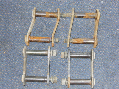

tim (hosehustler) supplied me a pair of ln106 front leaf springs as the origionals are sagged beyond help.
the back end has had a shunt at some stage, so i got stuck into replacing the rear shackles and shackle bushes today. it drives so much better...

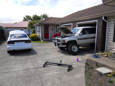

Re: LN60 surf build
haha you can just spot the axle stands under there for extra (wobble) protection...
my last hilux had a 1kzt conversion, so this one is much slower, but goes very well compared to other 2.4's ive driven.
looks like its been well looked after through its life

Re: LN60 surf build
Fakey wrote:You mean the stands right up the front?
yeah those ones! bad photo angle.... i'm not that silly

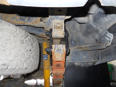

ok so the left rear eye mount is a little bit dog looking.
obviously was welded back on after the shunt that wrecked the shackles.
what do you guys reckon? tidy up and reweld, or put a replacement one on?
will be going to tomsoffroad in the weekend for a reweld if its going to be fine.

that eye mount does look bit dodgy. I'd be taking it to tom to get his opinion.
Re: LN60 surf build
fair call. i have a 4x4 trip up around benmore tommorrow. i'll whip it over to him after that

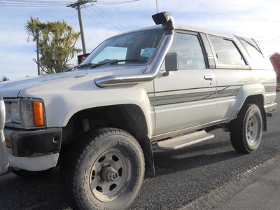

ok, yesterday was productive.
the surf now has a cool new snorkel.
all stainless steel, seamless with a brushed finish.
i'll whip the pics up later tonight!

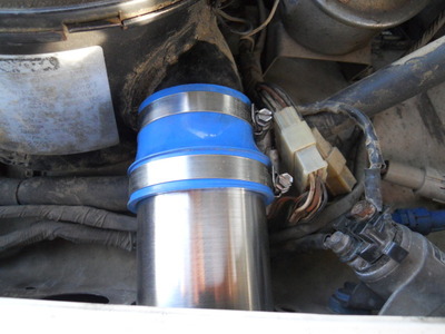

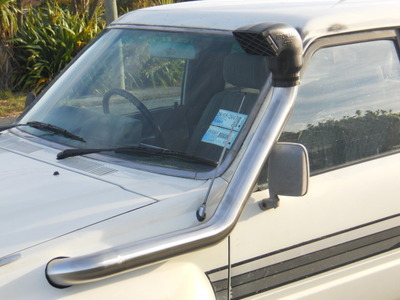

Re: LN60 surf build
here ya go
- Attachments
- no seams to be found here!
- DSCN1662.jpeg (47.93 KiB) Viewed 6305 times
- nice and simple joins for less then 10 bucks ;)
- DSCN1661.jpeg (46.37 KiB) Viewed 6305 times
- the only shiney part on the truck
- DSCN1663.jpeg (87.03 KiB) Viewed 6305 times

Re: LN60 surf build
kool looking surf you got there. not to often you find them that tidy.
mine looks like a golf ball compared to your one

Re: LN60 surf build
Snorkle looks awesome, where'd you get that bent up?

Re: LN60 surf build
very tidy wee snorkel alright.. just be careful nudgin past tree's or banks as it could cause (depending on how its mounted) trouble for ya windscreen or snorkel itself..

surf10 wrote:kool looking surf you got there. not to often you find them that tidy.
cheers! its reasonably striaght for its age. little bits of cancer starting but nothing major.
wayfastwhitee wrote:Snorkle looks awesome, where'd you get that bent up?
it ain't bent up
shes made of mandrel bends and straights.
about 7 tigged joints i think, but they got ground down and the whole thing had a brushed finish polished in. looks seamless now

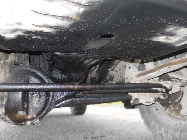

Re: LN60 surf build
okey dokey, took it for a 4x4 in the weekend and managed to blow oil all over the underside of the truck. front crank seal was leaking quite a bit, so i pulled it to bits and put a new one in. i was putting it all back together and spotted the sump gasket was also falling out (explains even more as to why theres so much oil). what the hell couldve caused that!!!!? also found greasy slime in the cooling system. i hope like hell the engines not screwed!
it apparently had the head gasket done in it, and i can see newish gaskets all over the place.
should i really bother with this motor? i cant really afford to buy a good 2.8 to jam into it right now. i can get the necessary parts to rebuild a knackered one at cost price through work.
what should i do?????

Re: LN60 surf build
put a new crank seal in. and when i checked the timing, the cambelt snapped like a match stick. barely any resistance whatsoever. i can only put it down to possible oil contamination. went the whole slog and ended up replacing everything while i was in there. lets hope the engine holds together till i find another motor...

Re: LN60 surf build
ok, day off today so i tidied up residual oil left from the leaking sump gasket.
got it right on the second new gasket
they are tricky things to get the right tension on the bolts too! a little over tight and it splays out the gasket ends and starts leaking.
