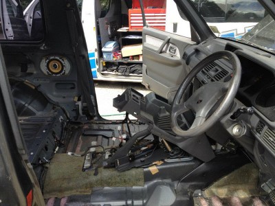

Thanks heaps, i have all the interior for the thing just took the carpet out bcoz think there is a leak somewhere thinking the sunroof, so getting that all repaired...

WHOOPS wrote:Thanks heaps, i have all the interior for the thing just took the carpet out bcoz think there is a leak somewhere thinking the sunroof, so getting that all repaired...
welcome to my world.
open your sunroof and check the drain pipes are all unblocked (pour water down them)
i've got a leak somewhere in the front left corner of my pajero. have had guard off and siliconed up a saggy wiring grommet, checked everything. only thing left is the actual screen leaking now.
horrid.

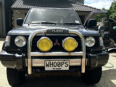

Sorry guys been playing with another car of mine and poor paj was just left doing nothing, after my mate brought one it kinda kicked in again...
so I've done a 2" body lift with some 15x10s and some 33s and 15x10 with 33 spare wheel not seen in photo tho
Got a nice winch and front bar to come should be expecting this in sept...
Photos with wheels on but havent been lifted yet
Paj with 2" body lift
