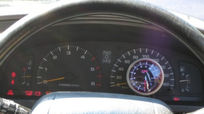

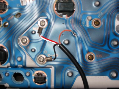

I got a autogage egt 60mm stepper motor gauge for my kzn185, finial got to rip off the egr valve etc and fitting the gauge to find I lost the instructions.
I need to know what the red, black, white, and orange wire are for.
Thanks

Try this (educated guess)
These two are logical
Red Batt +
Black Batt -
Now these two could be either way...
Orange Backlight in gauge
White EGT probe
or email
http://www.autogauge.com.my/
Red Batt +
Black Batt -
White EGT probe
or email
Re: autogage egt wiring
Got it sorted after trying a couple of options, red and white power, orange lights, black earth.
